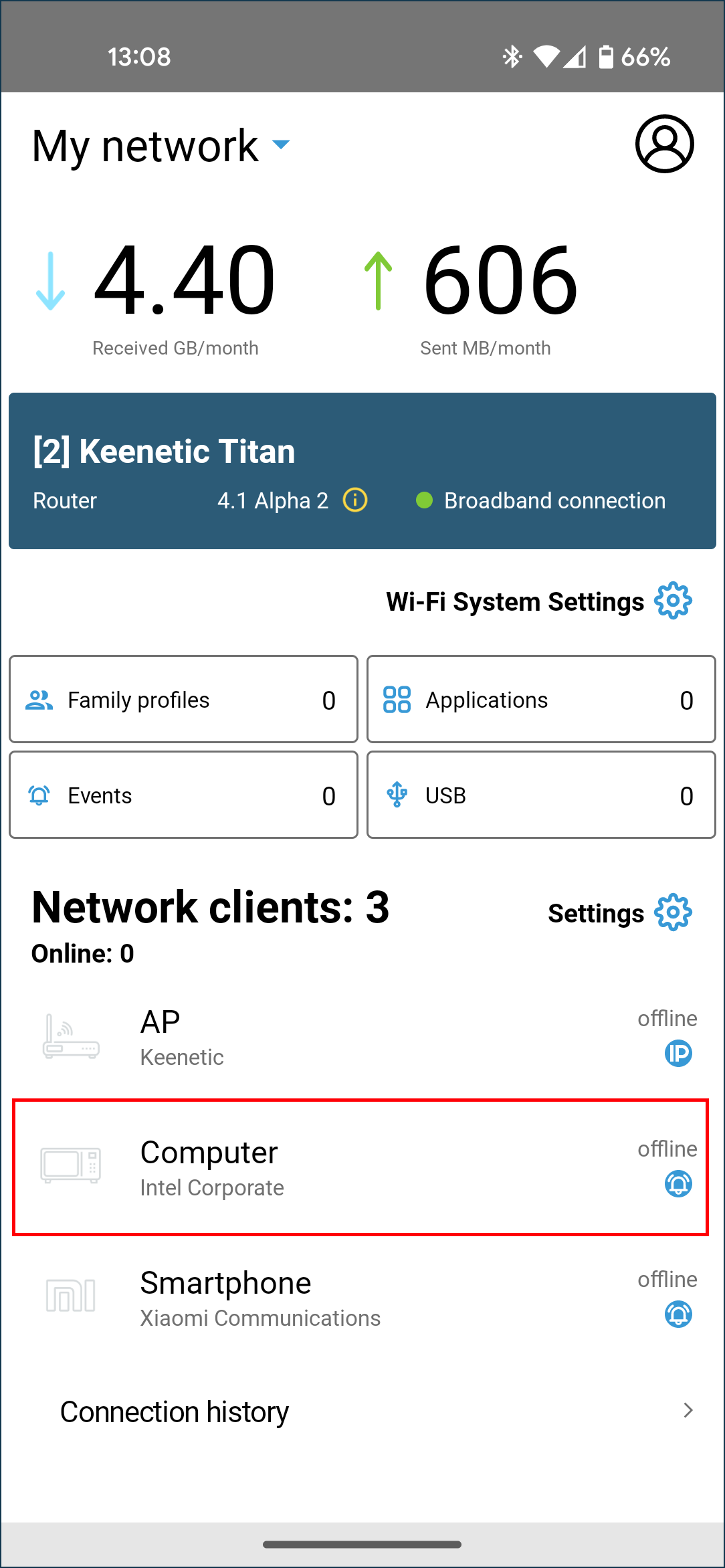

Let's show this with an example. Suppose we want to remove a client device named 'Computer' from the list of network clients.

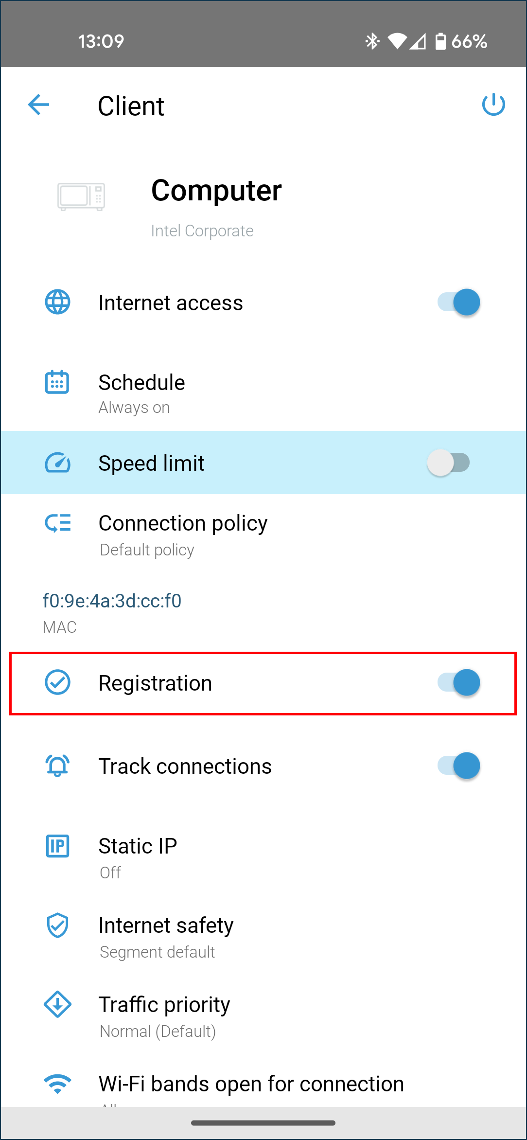

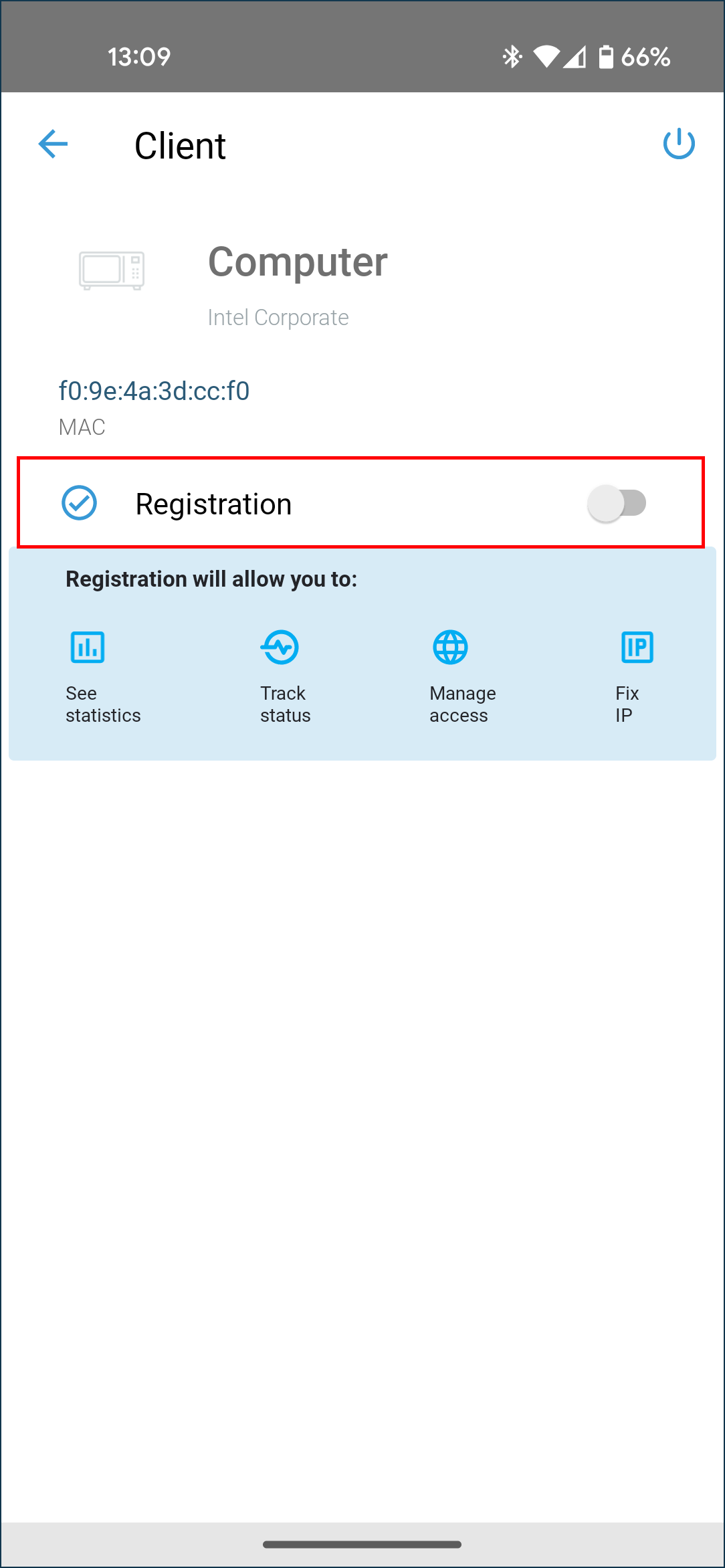

Click on this client device's entry and turn the registration off.

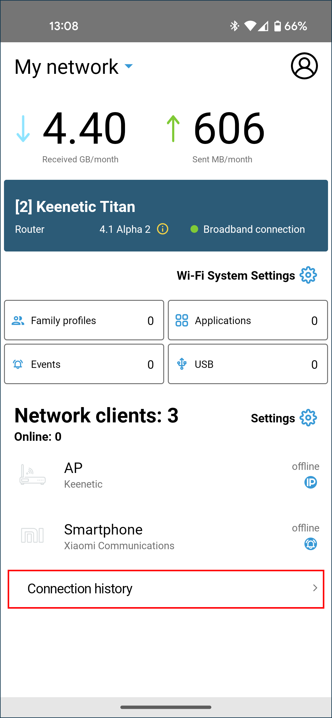

Then open the 'Connection history' list (located at the bottom under the main 'Network clients' list), as the client will automatically be in this list after deregistration.

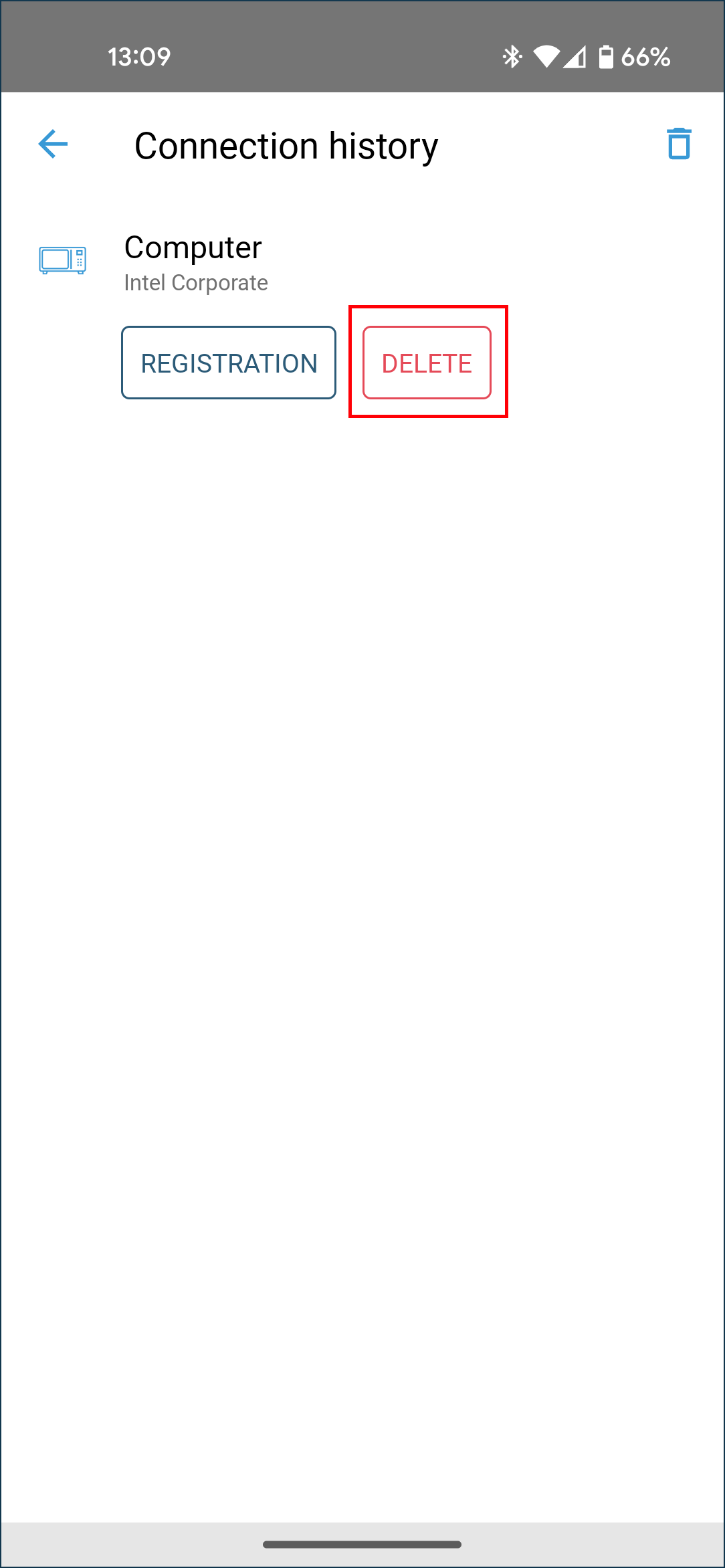

In the 'Connection history' list, you will be able to remove a specific client. To do this, click on the client entry, and the 'Delete' button will appear.
On this screen, you can also clear the entire list. To do this, click on the bin icon in the top right corner of the screen.
