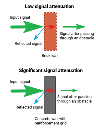

In Wi-Fi wireless technology, radio frequencies are used for signal transmission. Almost nothing affects the signal in an open space, but when it passes through various obstacles (it can be walls, doors, furniture), it becomes weaker or reflects. Each obstacle in the signal range reduces or reflects its power. The more obstacles, the worse the signal becomes.
Keep in mind that the Wi-Fi signal not only bends around an obstacle but it also passes through it, which results in additional reflection and absorption of a part of the original signal.
Some obstacles absorb the signal quite heavily, especially concrete walls and ceilings, and some, like mirrors and steel doors, highly reflect the signal.
Not only the number of walls in the signal path affects the quality of the signal, but also their thickness and the material of construction.

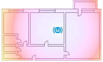

So, we want the Wi-Fi signal between the wireless network devices to pass through fewer obstacles and, if possible, freely pass through open doorways and arches. In this case, the signal will be stronger and better.
NOTE: Important! When placing the router, minimize the number of walls in the area where the signal passes from user devices to the router. The more obstacles there are, the worse the signal is. The strongest and most confident signal level will be in the room where the router is. The optimal location is approximately in the middle of the apartment.

Suppose you've decided where to place the router. Temporarily install it and check the quality of the Wi-Fi signal in different rooms. If the signal in a room is very weak, try to move the router closer to that room and recheck the signal level, first in that room and then in other rooms.
The signal reception quality can significantly change if you move or turn the router around a bit. Even a slight turn or shift of the device can improve or decrease the signal quality.
If the router is placed not in the centre of the apartment but, for example, in the kitchen or a distant room, 'dead zones' may occur in remote rooms with no signal. The layout of the apartment itself, the number of doorways and arches, i.e., the places through which the signal passes without loss of quality, affect the signal distribution. If the apartment's layout is non-standard, then the method for determining the optimal location of the router will be more difficult.
