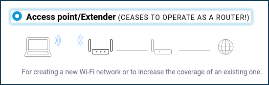

Access Point/Extender Mode
Access Point/Extender Mode is useful if you do not have a Wi-Fi hotspot in your network yet, or if you want to extend the range of your existing network over Ethernet. In this mode, Keenetic will work as a regular network switch with a Wi-Fi hotspot. Access Point can only be connected to your main Keenetic router via an Ethernet network cable. Home devices can be connected to your Access point via both Wi-Fi and an Ethernet cable.

For other Keenetic models, operating mode change must be done via the web interface. On the 'General system settings' page, click 'Change operating mode' and choose the 'Access Point/Extender Mode.
You will see a warning window about changing the device's operating mode. Press 'Change mode' to confirm.
