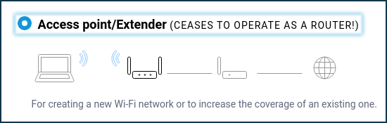

For other Keenetic models, operating mode change must be done via the web interface. On the 'General System Settings' page, click 'Change Operating Mode' and choose the 'Access Point/Extender Mode'.
You will see a warning window about changing the device's operating mode. Press 'Change mode' to confirm.

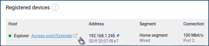

By default, in Access Point/Extender mode, the wireless network will work with the password and SSID indicated on its back label. You can change these settings In the web interface by the IP address assigned to it by the main Keenetic in your network. You can view this IP address on the main Keenetic, 'Client lists' page.
In our example, Keenetic in the Access Point/Extender mode received an IP address of 192.168.1.33 from the main router, accessible from the local network. You can enter its web interface and make additional settings. For example, you can change the Wi-Fi network's name to the same name as on the main router. If necessary, you can use Wi-Fi seamless roaming (automatic switching Wi-Fi clients between access points) in this mode.
