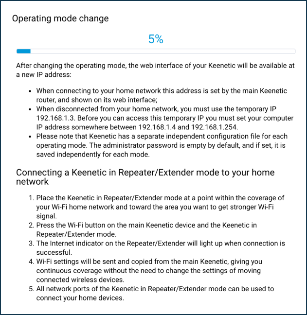

You will see a window warning you about switching the router's mode. Click 'Change mode' to confirm.
Then you will see a progress bar for mode switching and an information message about connecting the router to your home network in the selected mode and how to connect to its web interface after mode change.

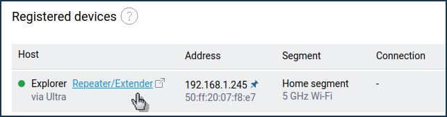

The router in the Repeater/Extender Mode will need to connect and obtain an IP address from the main router. This IP address can be viewed on the main Keenetic's web interface on the 'Client Lists' page.
In our example, the Keenetic in the Repeater/Extender Mode received an IP address 192.168.1.33 from the main router. This IP can be used to get access from the local network. You can enter its web interface and make additional settings if necessary.
