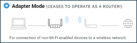

In Adapter mode, Keenetic operates as a wireless bridge with its own access point disabled, providing access to the Wi-Fi network to all client devices connected to its network ports. This way, you can avoid routing an Ethernet cable to your IPTV, computer, or other clients without a Wi-Fi adapter. You can only connect to the main Keenetic via Wi-Fi. A Keenetic router in Adapter Mode can only be connected to your main Keenetic via an Ethernet network cable. Home clients can be connected to your Adapter via both Wi-Fi and an Ethernet cable.

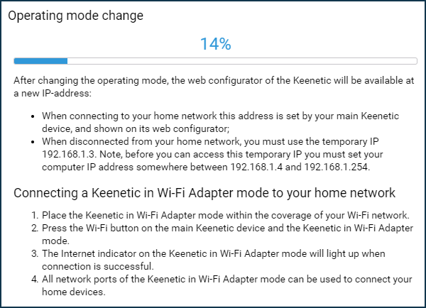

It is assumed that the device receives an IP address via DHCP from the main router by default. If no IP address has been obtained, the device is assigned a service static IP address of 192.168.1.3. When a DHCP server appears on the network, the service IP address is automatically disabled. You can only connect to the web interface using the new IP address that will be obtained from the main router via DHCP.

On the 'General System Settings' page, click 'Change Operating Mode' and choose Adapter Mode.

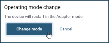

You will see a warning window about changing the device's operating mode. Press 'Change mode' to confirm.
Next, you will see the mode change status and an information message about connecting your Keenetic in the selected mode to your home network and how to access its web interface after changing the operating mode.

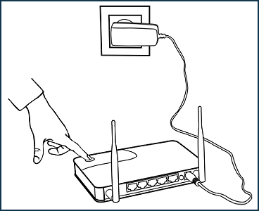

So, to set up the connection between the Adapter and the main Keenetic, tap (not hold down, just press and release) once or twice (respectively to connect to a 2.4 GHz or 5 GHz Wi-Fi network) the wifi-button.png (WPS/Wi-Fi) button on the Keenetic in Adapter mode.
Similarly, press the wifi-button.png button on the main Keenetic.
After pressing the WPS button on both Keenetic devices, Wi-Fi LEDs on both of them will blink actively. Wait for the devices to agree on all parameters and automatically establish a connection. This usually takes no more than a minute.
After the connection has been successfully established, the globus.png (Internet) LED on the Adapter will light up. This completes the configuration of the Keenetic in Adapter mode.
