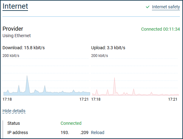

The Ping Check mechanism is enabled on this primary connection. It will continuously test whether the Internet connection is working properly. In the event of a failure of the main network connection, the Keenetic router will automatically switch to the alternate channel. When the main connection is restored, it will return to it. It is recommended to enable Ping Check on the main connection.
After completing the primary connection setup, make sure that the Internet connection has been established.

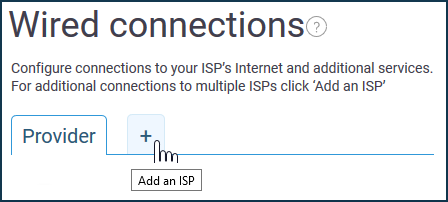

To connect to multiple ISPs simultaneously, press '+ (Add an ISP)' on the 'Wired' menu page.
Then, set up Internet access according to the conditions of your ISP connection.

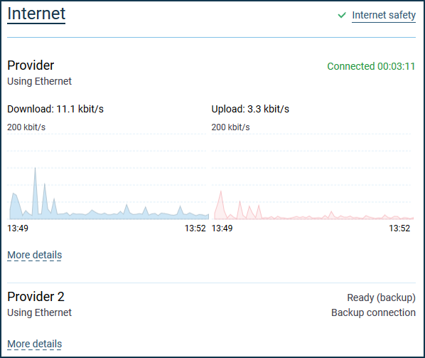

4. After we connected two Ethernet cables from different ISPs and thus finished the main Internet channel redundancy setup configuration, the Dashboard's Internet info panel should now display the currently active connection (Provider) and the standby connection (Provider 2).
To check the functionality, disconnect the main ISP network cable from the router's blue port 0 (WAN/Internet).
The KeeneticOS will automatically switch to the backup channel if the primary connection is impossible to establish.
The Keenetic will automatically return to the main channel when the primary connection is restored.
