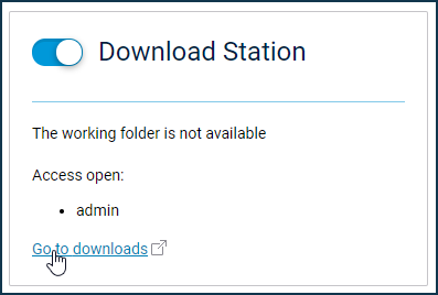

Go to the 'Applications' page, and in the 'Download Station' section, click on the 'Go to downloads' link to connect to the built-in Transmission client interface.

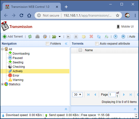

Clicking on this link in your web browser will open the 'Transmission WEB Control' window.
You can also open the torrent client window in your web browser by entering <IP-address>:<control_port> (e.g. 192.168.1.1:8090).

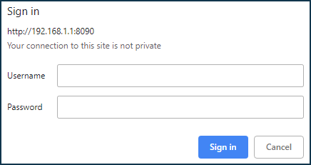

An authentication window will appear; you should input the username and password of an account with access to the Transmission torrent client settings.
After you sign in, the 'Transmission WEB Control' window of the torrent client will be opened in the web browser.

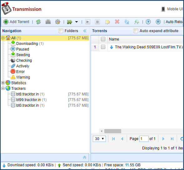

Now let's have a look at the interface of the built-in Transmission torrent client version 2.84.

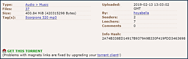

Find the content you need (it can be a movie, an e-book, a music album, a program, etc.) on the tracker (a specialised server).
Download a torrent file (*.torrent is a metadata file that contains the URL tracker, information about the files, their checksums, hash, etc.) and save the *.torrent file to your computer.

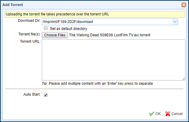

Now add the downloaded torrent file to the Transmission interface by clicking on the 'Add Torrent' button. button01_en.png.

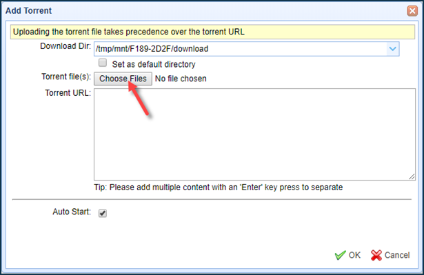

You will see the 'Add Torrent' window; click the 'Choose Files' button there.
Find and select the downloaded torrent file (file with .torrent extension) in the opened window.
Then make sure the 'Auto Start' option is enabled and press OK to add a new torrent.
The torrent client starts looking for peers and seeds currently downloading and distributing this torrent with you. After that, the download of the file(s) will start.

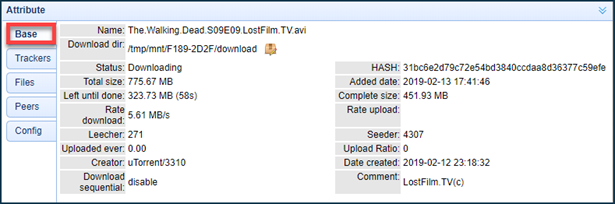

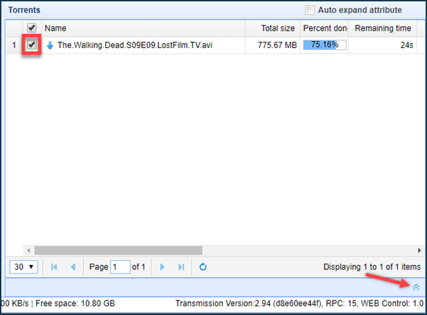

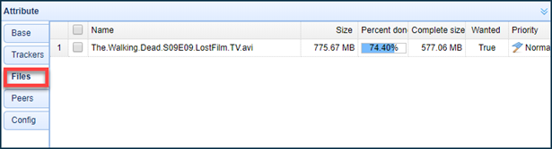

You can view the currently downloading torrent information by selecting it in the list and unfolding the bottom menu 'Attribute'.
The 'Base' tab displays the current torrent activity screen (status, download progress, duration, etc.) and other information (size, origin, URL link, etc.).

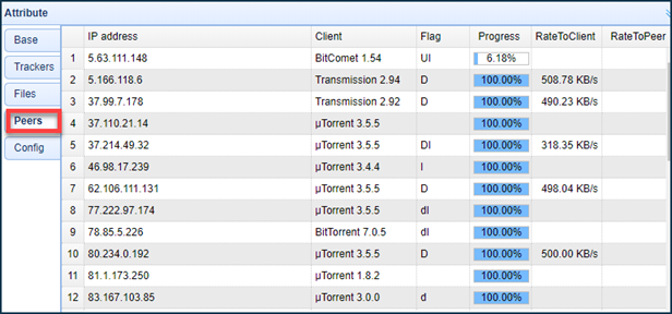

The 'Peers' tab shows the information on the clients involved in the distribution (download speed, status, client IP address, version of the torrent client).

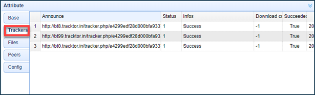

The 'Trackers' tab displays information about the trackers of the torrents.
The 'Files' tab shows the list and status of files for a particular torrent.
The 'Config' tab allows you to make necessary settings for the selected torrent.

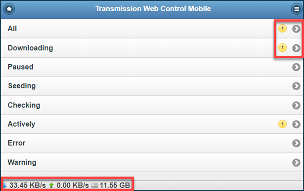

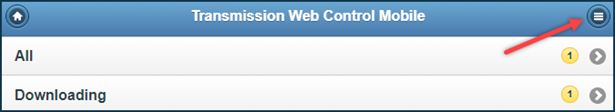

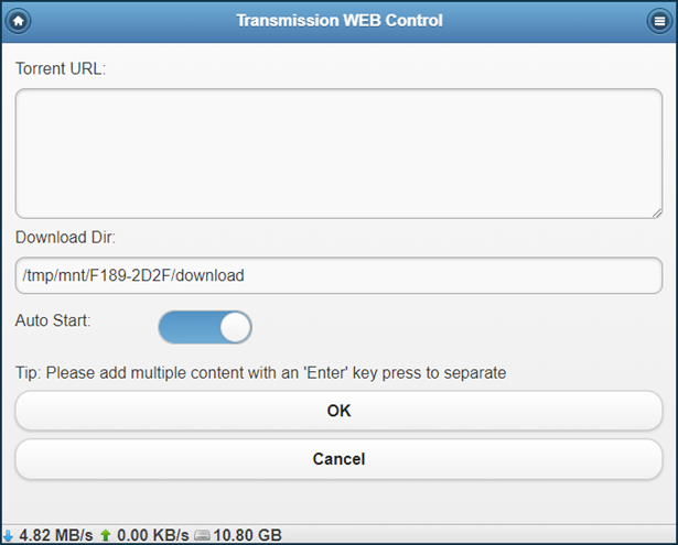

Transmission 2.84 also has a lightweight mobile interface (Mobile UI) adapted for management from mobile devices.
To access the mobile interface, click on the icon button02_en.pngin the upper right corner of the screen. You can check the status of downloads here.

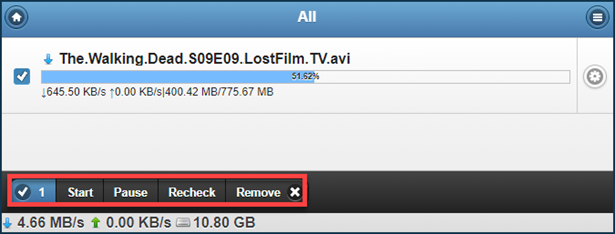

You can control (pause, start, recheck, remove) a specific torrent by selecting it.

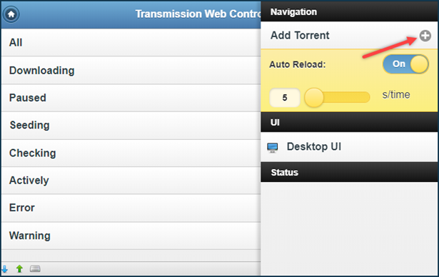

You can add a new torrent in the drop-down menu (upper right corner).
Click "+" to add a new torrent.
Then you will see a page on adding a link to the torrent file.

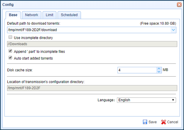

After you click the 'Settings' icon trans29.png, you will see the window with the following tabs: 'Base,' 'Network,' 'Limit'  and 'Scheduled.'
Additional settings for downloading and distributing torrents (e.g., auto start added torrents, append '.part' to incomplete files) are on the 'Base' tab. You can also change the interface language and choose a folder to download files.

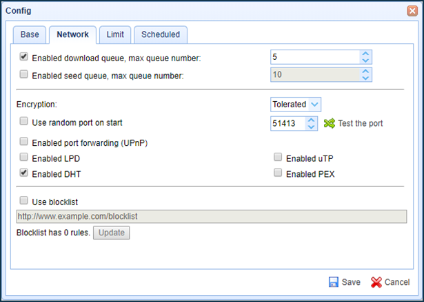

The 'Network' tab contains settings for limiting simultaneous downloads and distributions; assigning the port parameters used by the torrent client (you can manually set the port number or use a random port each time); enabling/disabling the μTP, LPD, DHT protocols and peers exchange; the ability to use encryption mode.
  • Enable download and seed queue — the number of simultaneous downloads and distributions allowed in the torrent client;
  • Encryption — enables encryption of torrent activity for privacy purposes;
  • The port field specifies the port number through which BitTorrent users will access the BitTorrent network to download the files you are distributing, i.e., to support your distribution. The number specified in this field must be the same as the port number specified in the Keenetic Web configurator on the 'Applications' page, in the Download station settings section, in the 'Peers port' field.
    There is an icon next to the port trans22_en.png , it helps you to check port availability. The 'Open' status means that this port is open from the ISP side, and other users will be able to connect to you through it for downloading. The 'Closed' status means that the specified port is closed by the provider. In this situation, you will be able to download files (upload), and distribution to other users will be limited (it will affect the number of potential partners for file sharing).
    You can specify 'Use random port on start' in the settings, but the torrent client will automatically detect a random port number if you do it. We recommend using a fixed port number for your torrent client.
  • Enable port forwarding (UPnP) — your Keenetic will automatically forward the port used in the torrent client in it's NAT. It makes sense to enable this option if you are using a random port so that you do not have to configure port forwarding manually for each use.
  • Enable Local Peer Discovery (LPD) — the protocol is an extension for the BitTorrent file exchange system. It makes it possible to detect local BitTorrent peers and thus reduce the traffic passing through the ISP channel and maximise the use of the local area network (LAN) bandwidth.
  • Enable DHT — the protocol allows BitTorrent clients to find each other without using a tracker; it will enable to reduce the load on the tracker, to support participants in periods of inaccessibility of the tracker. DHT provides distribution without a tracker at all. The Keenetic will use more of its resources with DHT, which can affect its productivity.
  • Enable μTP — the protocol provides faster downloads because it works via the UDP protocol, where data exchange is more rapid than via the TCP protocol. The Keenetic will use more of its resources with μTP, which can affect its productivity.
  • Enable peer exchange (PEX) — the extension of the BitTorrent protocol to exchange member lists.

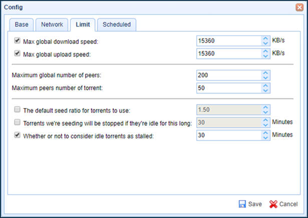

The 'Limit' tab is used to set up download and upload limits. Each Keenetic has its maximum, which allows it to perform essential functions. You can find the information about the maximum speed for each model above. Also, you can set the maximum global number of peers and the maximum peers per torrent here.

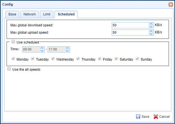

You can set alternative download and upload speeds on the 'Scheduled' tab and schedule when these restrictions apply.
Alternative speed can also be enabled manually by checking the appropriate box in the settings or by clicking the button trans27.png in the interface.
