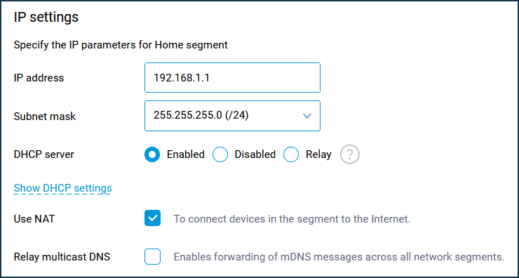

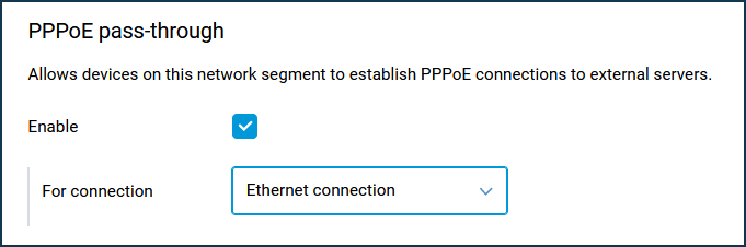

Home and Guest network settings are shown on 'My network and Wi-Fi' section. By default Home network (Home segment) combines LAN ports of the built-in switch with main Wi-Fi access point (here wired and wireless hosts are implied). And for the Guest network (Guest segment) a separate Wi-Fi network is considered. This network is isolated from the home network. Segmenting the network allows to improve its security and optimize the network's performance. A segment is a logical interface that can include one or more physical interfaces. Within a single segment, all interfaces are combined into a network bridge. The segment settings include the following parameters — network identifier (VLAN ID), IP parameters (IP address, subnet mask, DHCP server, IP address lease time), access profile for unregistered devices, IGMP Proxy And PPPoE transit connections (PPPoE Pass Through).

4. In 'IP settings' section, you can change the local IP-address and DHCP settings. You can find the additional information in the 'Changing IP and DHCP settings in the Home segment' article.
