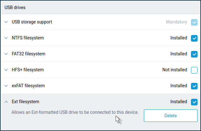

NOTE: Important! To use OPKG packages, you need a USB drive connected to the router. The drive must be formatted in the EXT file system. We recommend using the current and up-to-date journaled EXT4 file system.
The 'Ext filesystem' component must be installed in your Keenetic router for the drives to work with EXT4. You can check this on the 'General system settings' page under 'KeeneticOS update and component options' by clicking on 'Component options'.
