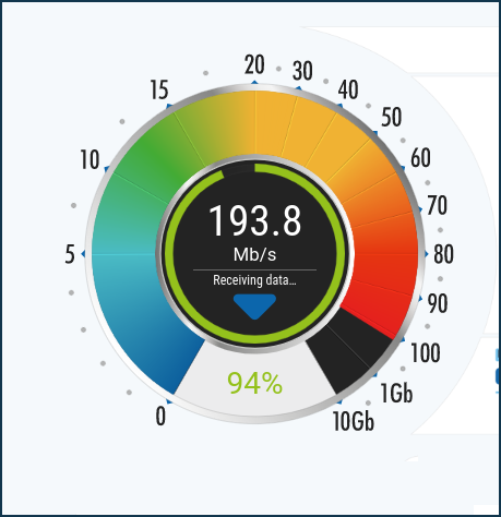

Another popular online service is nPerf. It also allows you to check the speed of your Internet connection.
If the figures obtained from Speedtest and nPerf are very different from those stated in your tariff plan, we recommend you check the speed of your Internet connection by downloading a large file.
