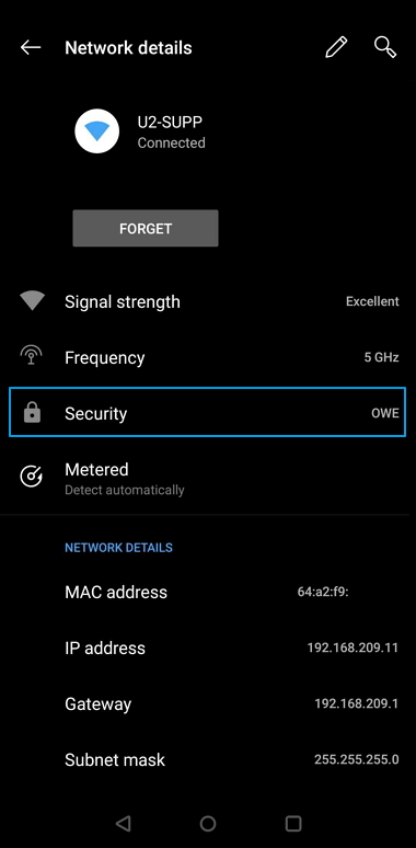

Below are some examples of connections on a Oneplus 6 smartphone (Android 9).

OWE open network protection:

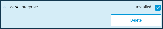

To use the WPA Enterprise protocols, you must install the 'WPA Enterprise' system component. You can do this on the 'System settings' page by clicking on 'Component options'.
After that, you can configure the WPA Enterprise protocols in the Wi-Fi settings.
