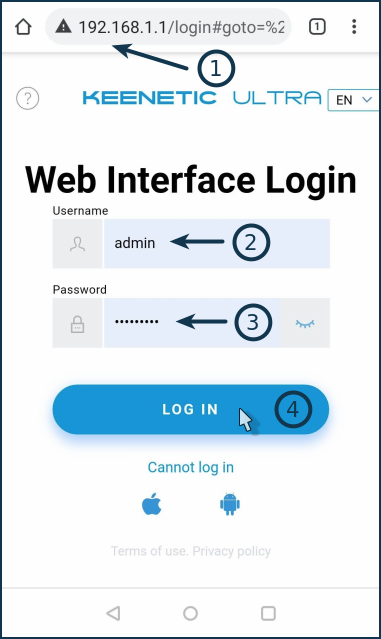

Connect from your mobile device to your Keenetic's Wi-Fi network. Then open a web browser and type 192.168.1.1 or my.keenetic.net in the address bar to connect to the router's web interface.
In the 'Username' field, type 'admin' (in English lowercase letters).
In the 'Password' field, enter the administrator password for the router.
Important! The administrator password is not set by default (in the factory settings); the user sets it during the initial setup.
Click 'Log in' to continue.

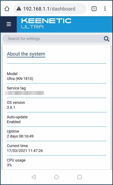

If the connection is successful, you will see the web interface (Control Panel) screen of your Keenetic. Scroll down to the 'About the system' section. The 'OS version' line displays the current version of the KeeneticOS operating system. If an update is available, install it.

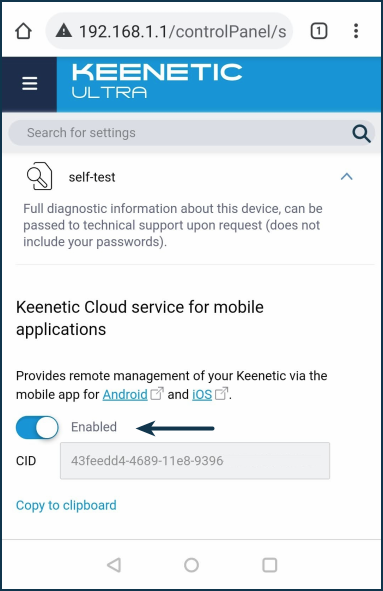

Click on button.jpg  or m-hamburger.png (hamburger icon) in the upper left corner of the screen. The navigation menu will open on the sidebar. Scroll down and go to the 'System Settings' menu.
The switch must be set to 'On' in the 'Keenetic Cloud service for mobile applications' section.
