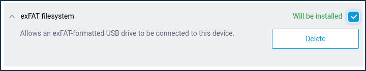

The 'exFAT filesystem' component must be installed on your Keenetic router to support USB drives with the exFAT file system. This can be done in the web interface on the 'General system settings' page, in the 'Updates and component options' by clicking on 'Component options'.
After installing the component, connect the exFAT drive to the Keenetic router's USB port.

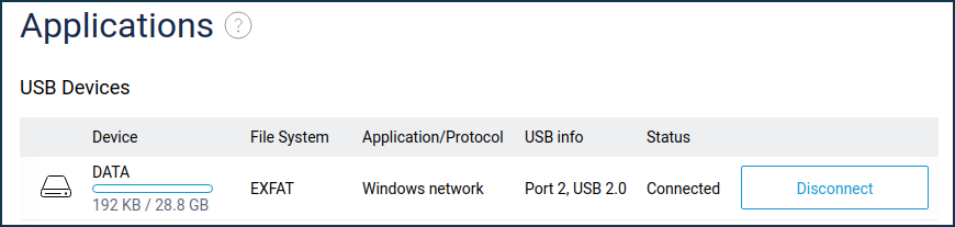

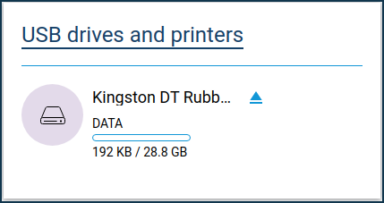

This example shows the connection of an exFAT formatted flash drive.
The following messages will appear in the router's system log when a USB drive is connected:
