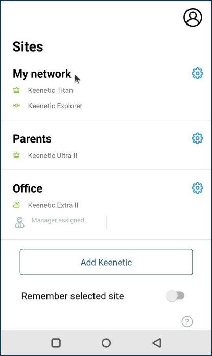

The mobile application uses the same administrator login/password as the router web interface. Run the previously installed Keenetic application on your mobile device. The starting 'Sites' screen will show all the routers added for management. Click on the site you want to connect to.

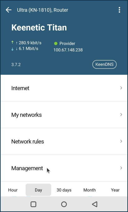

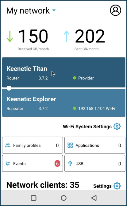

Then click on the router name in the centre of the screen to go directly to its settings.

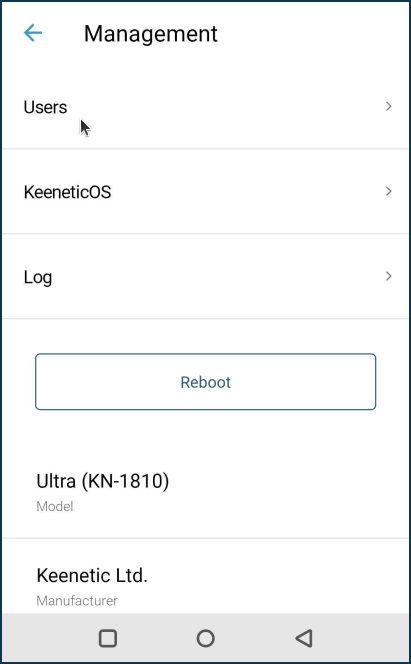

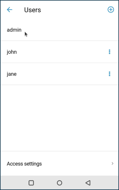

Go to 'Management' > 'Users' menu.

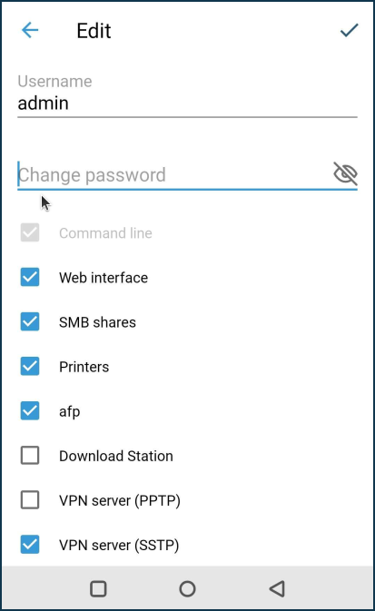

Click on the admin user entry and enter the new administrator password in the 'Password' field. Then click on the checkmark in the upper right corner of the screen to save your settings.

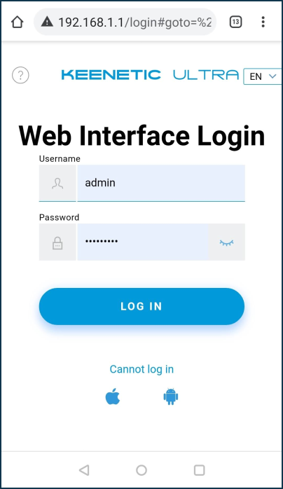

With the newly set administrator password, you can connect to your router's web interface using a browser.
