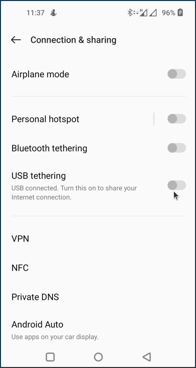

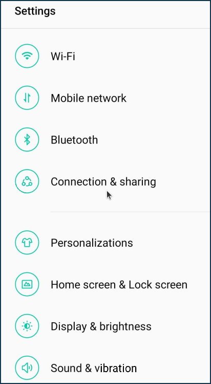

In our example, we are using a device with Android 12. In this version, open 'Settings', click on 'Connection & sharing' and activate 'USB tethering' mode.
This completes the phone setup.

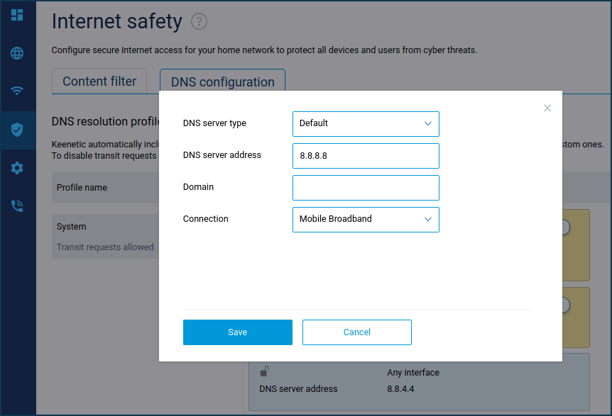

If sites do not open through the router, try adding additional DNS servers. You can do this on the 'Internet safety' page under 'DNS configuration'. In our example, a public DNS server from Google has been added for the 'Mobile Broadband' connection.
