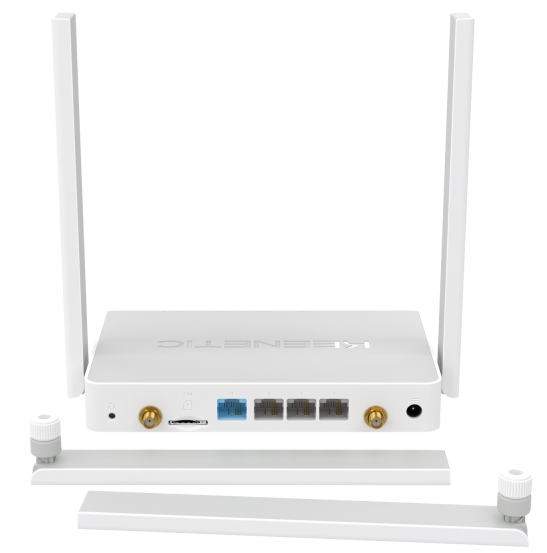

Keenetic Hero 4G+ (KN-2311), Runner 4G (KN-2211) and previous generation models Hero 4G (KN-2310), Runner 4G (KN-2210) come with two removable omnidirectional cellular antennas.
SMA female connectors are used on the housing; the antennas are equipped with an SMA male connector.

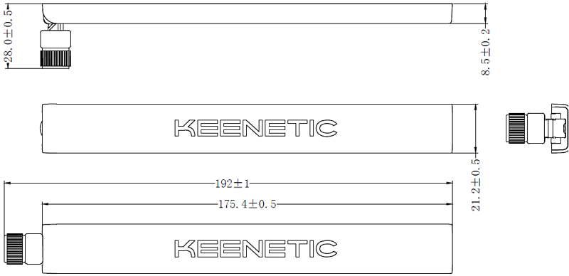

The physical dimensions of the complete antennas are shown in the figure (in mm):
