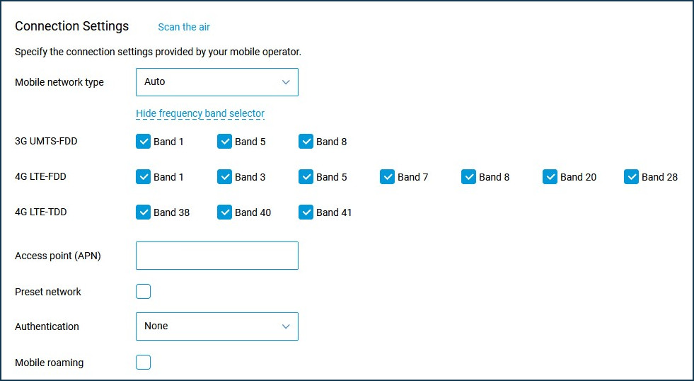

In the web interface, go to the 'Mobile' page and click 'Show frequency band selector' under 'Connection Settings'.
In the list of bands that appears, tick the desired ones.
