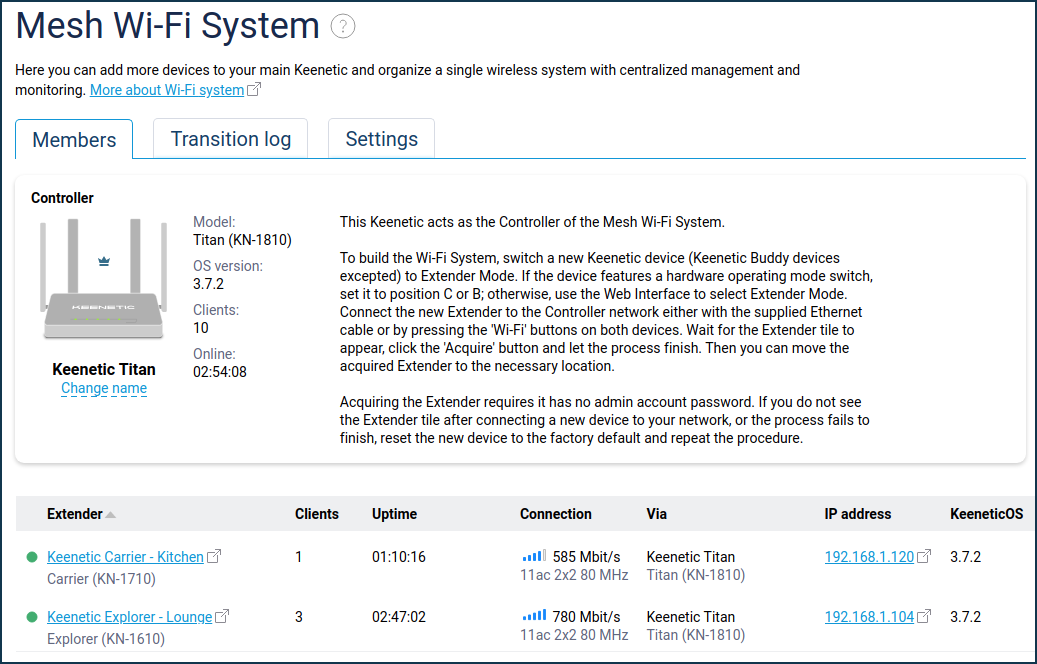

There is a Wi-Fi System of 3 nodes: 1 Main Router (Controller) and 2 Extenders.

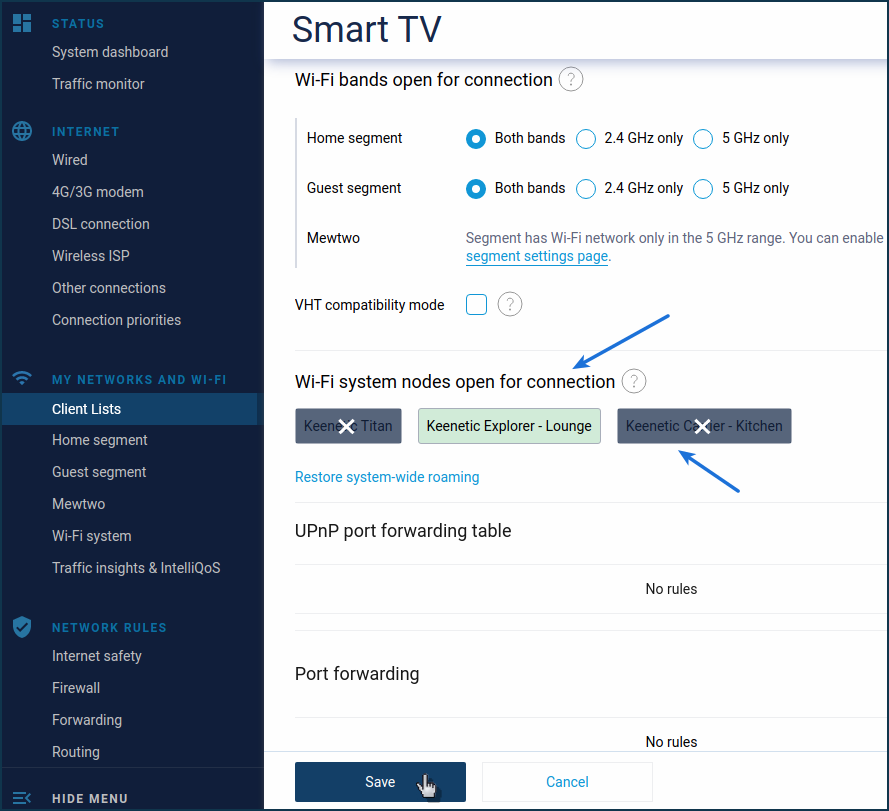

Suppose you want to configure your smart TV to connect only to a specific Extender (in our example, it is 'Keenetic Explorer - Lounge') as the TV occasionally connects to a distant router.

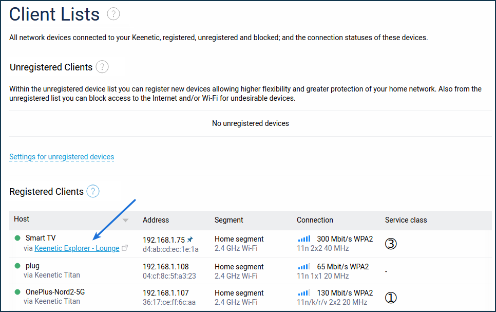

In the web interface of the Wi-Fi System Controller, go to the Client Lists, select the desired client and register it in the home network. Then, in the list of registered clients, click on its entry and in the settings window that appears in the 'Wi-Fi system nodes open for connection' section, leave only those nodes that will be allowed to connect to this client. In our example, you only need to allow connection to the 'Keenetic Explorer - Lounge' node.
Save the setting. Then, disconnect the client device from the Wi-Fi network and reconnect it. In the Client List, make sure that the device you have bound to the Wi-Fi System node is connected to the correct node.
