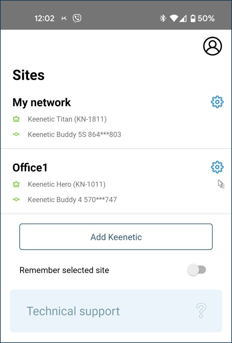

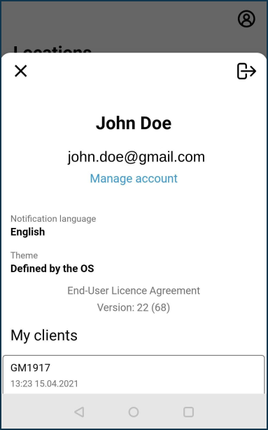

Here is an example. Suppose you want to share your router with someone else. Ask him to install the Keenetic app on his mobile device, create his own account in it, and give you the e-mail address that was given during account registration. This account must be authorized in the Keenetic app at the moment of adding the manager.

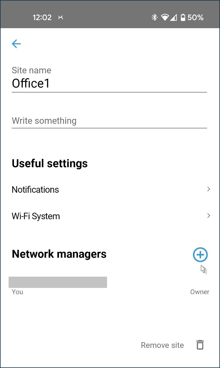

Next, on the 'Sites' screen, click on the site management settings icon ('gear').

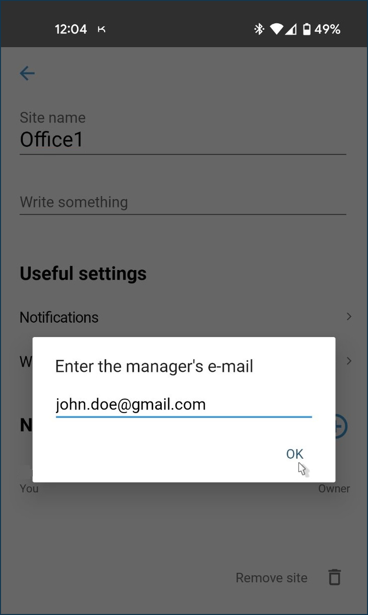

Under 'Network managers', click '+' to add an account that will be allowed access to the router.

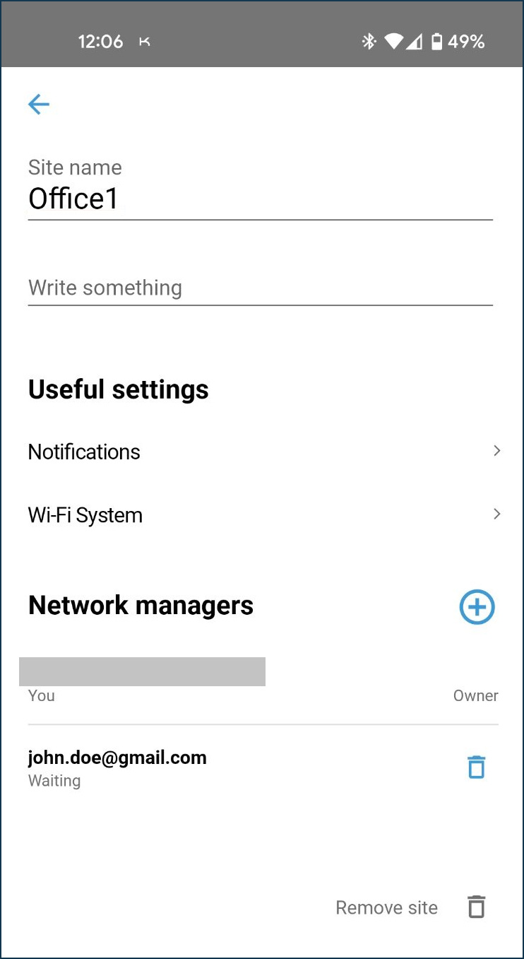

Enter the e-mail address of the second account that was previously authorized in the app on another mobile device.

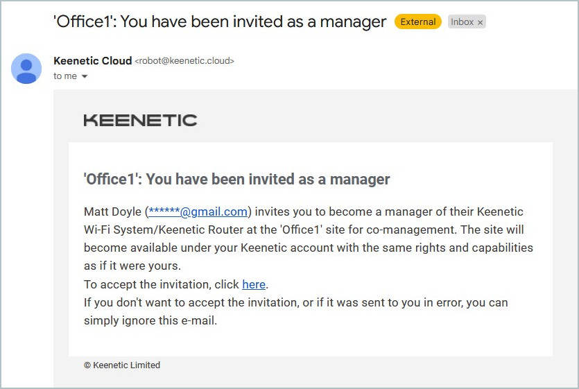

To confirm the e-mail address, the following message will be sent to the specified e-mail address:
Click on the link to accept the invitation.

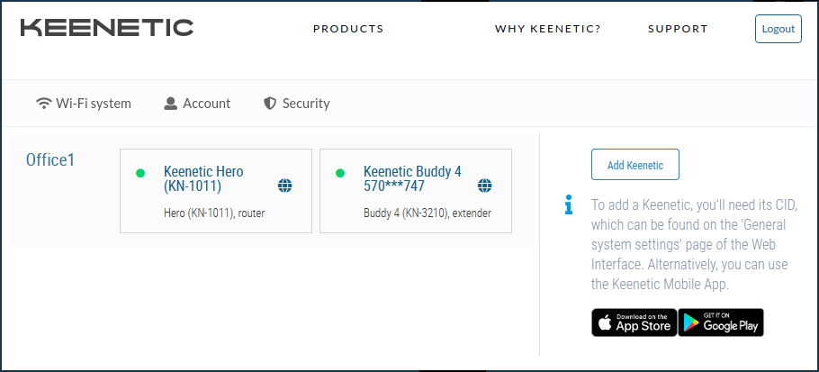

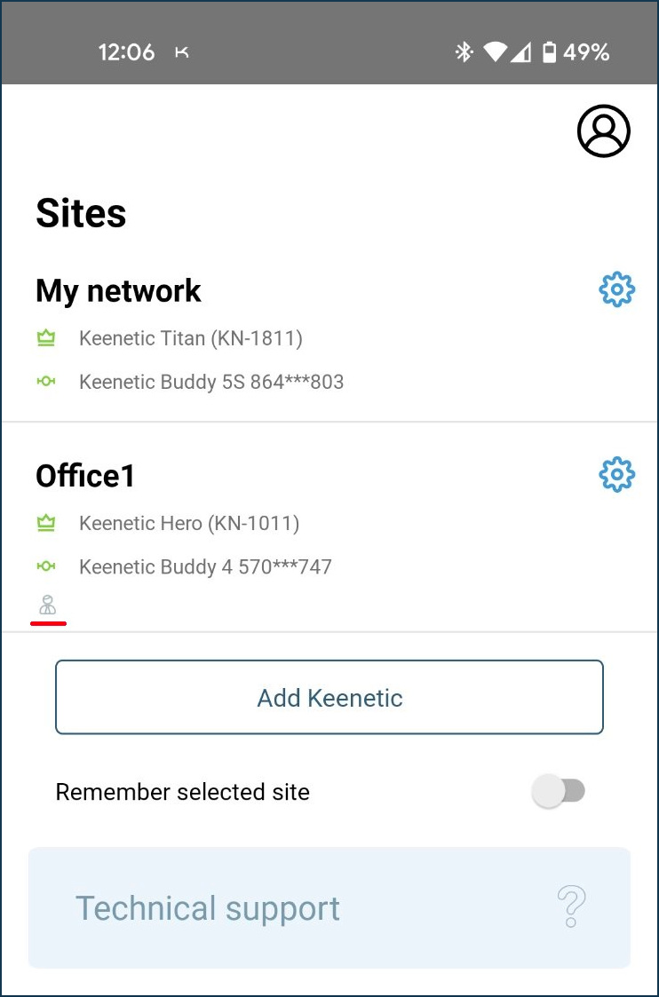

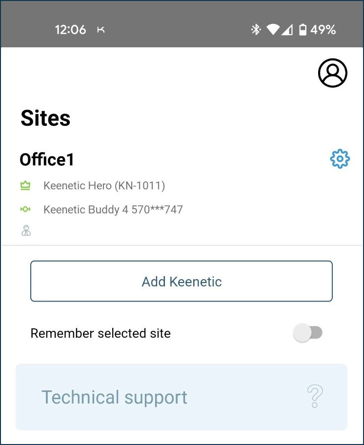

The site with the router will appear automatically on the manager's mobile device. The management will be available in the Keenetic app and on the Keenetic Cloud web portal.

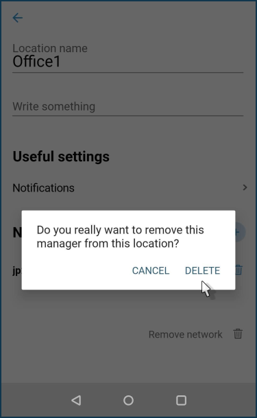

If necessary, you can delete a manager in the site management settings, and access to the router will be denied to him.
