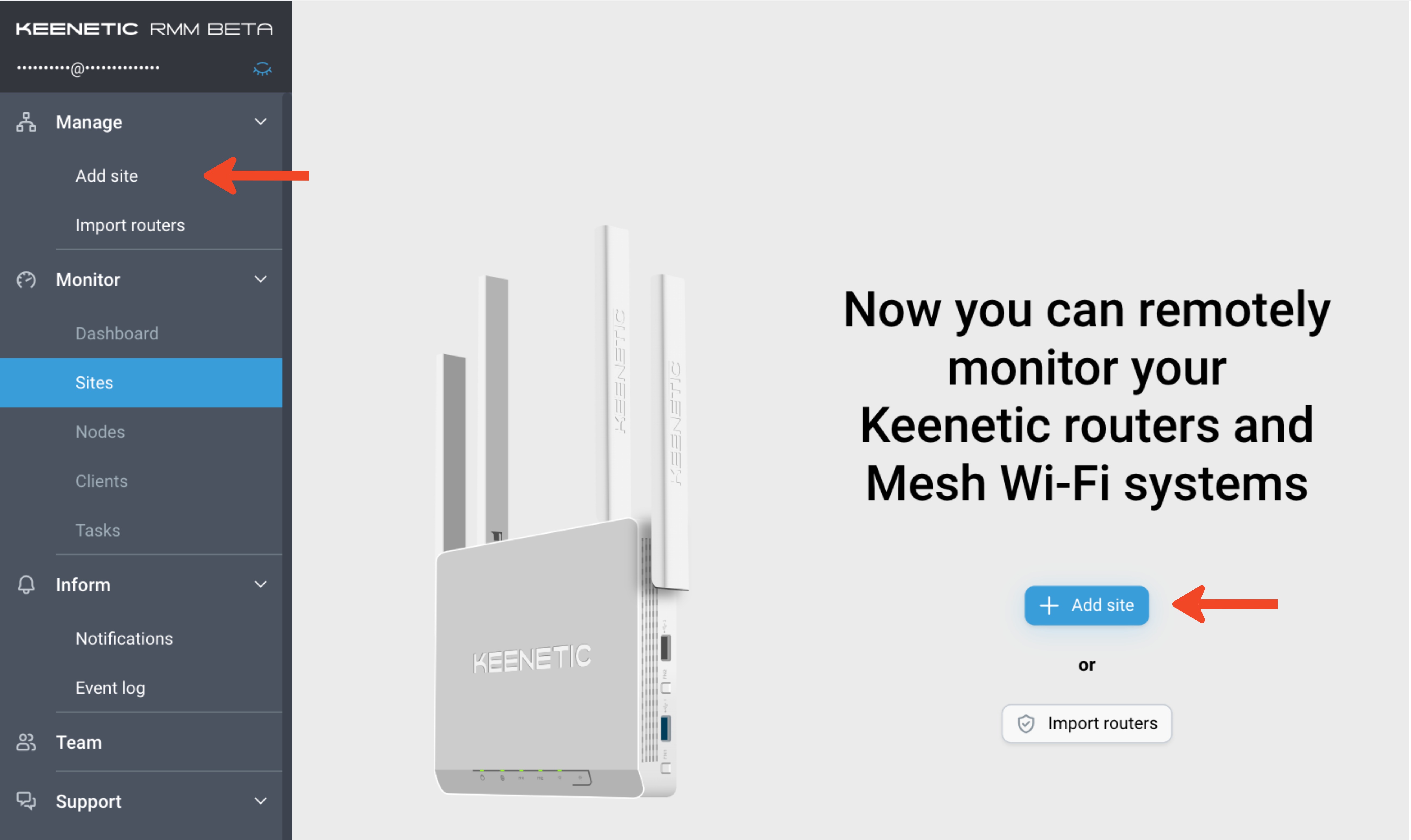

To add a site, click “Add site” on the Sites page or in the sidebar menu:

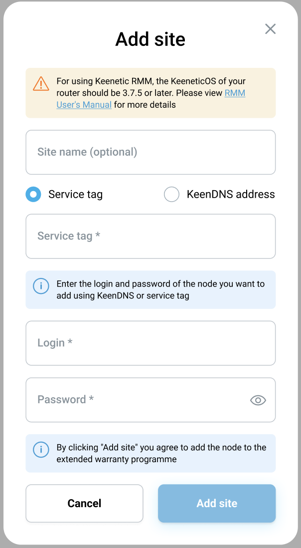

There are two ways of adding a site:
  1. Via “Service tag”, printed on the Keenetic device label, or you can find it on the System dashboard page in the Status menu of the device's Web Interface. It is a 15-digit identification code XXX-XXX-XXX-XXX-XXX.
  2. Via “KeenDNS address” — a convenient domain name service for remote access. To connect and configure KeenDNS, follow the KeenDNS service article.
Next, enter the login and password for your Keenetic device.
You can also assign a name to a site by entering it in the Site name field. If the field is left blank, the site is assigned the name of your Keenetic device.
NOTE: Important! For using the Keenetic RMM, the KeeneticOS version of your Keenetic device should be 3.7.5 or higher.
Note that Extenders not registered in the Keenetic Account before are automatically covered by the warranty programme when a Main router of a Mesh Wi-Fi system is imported into the Keenetic RMM.
