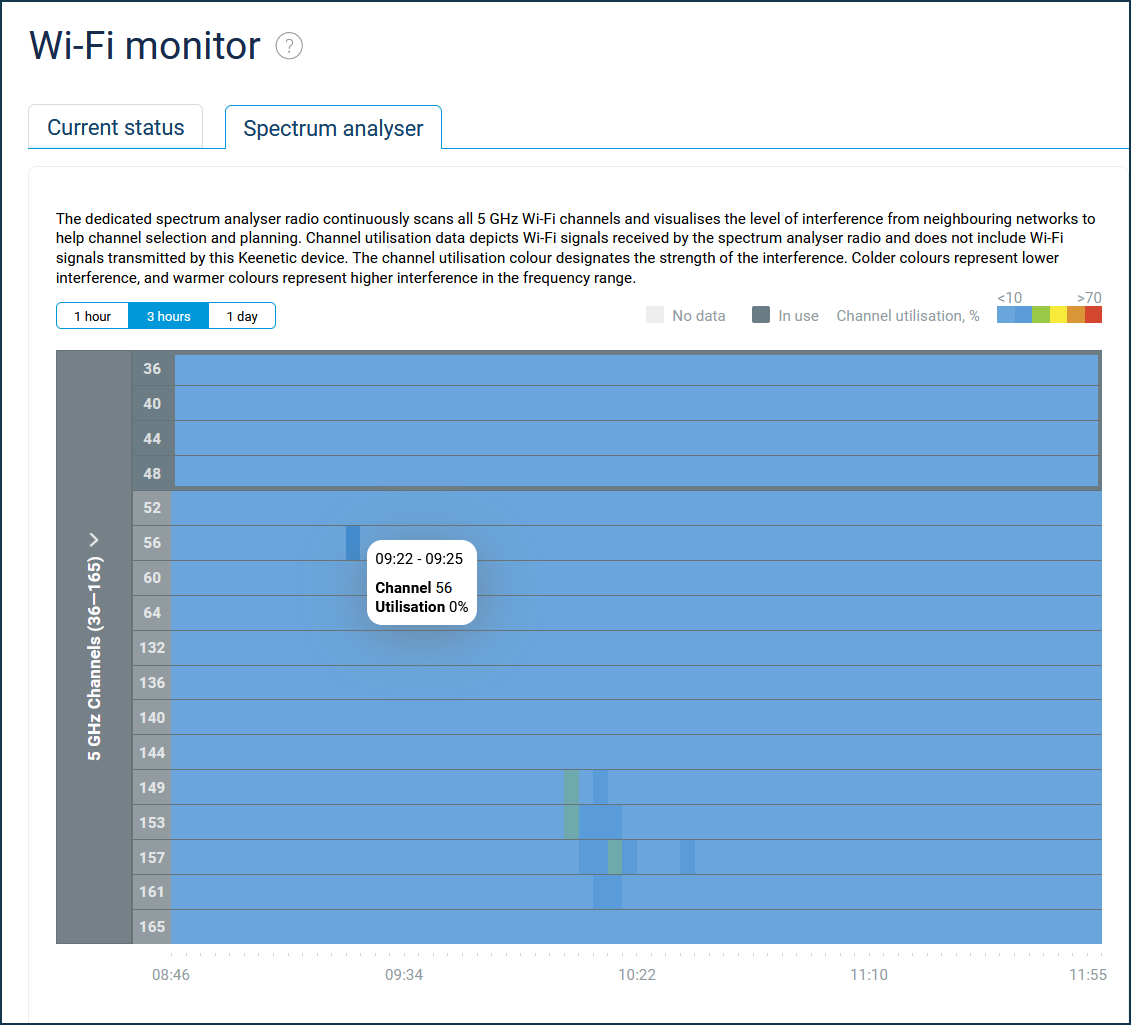

The 'Wi-Fi spectrum analyser' tab is located in the 'Status' menu on the 'Wi-Fi monitor' page.
The channel load data shows Wi-Fi signals received by an independent spectrum analyser and does not include Wi-Fi signals transmitted by this Keenetic device.

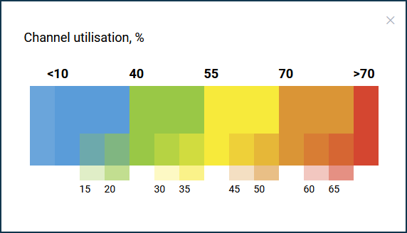

The channel load colour indicates the strength of the interference. Cold colours indicate relatively low interference and warm colours indicate higher interference in a given frequency range.
