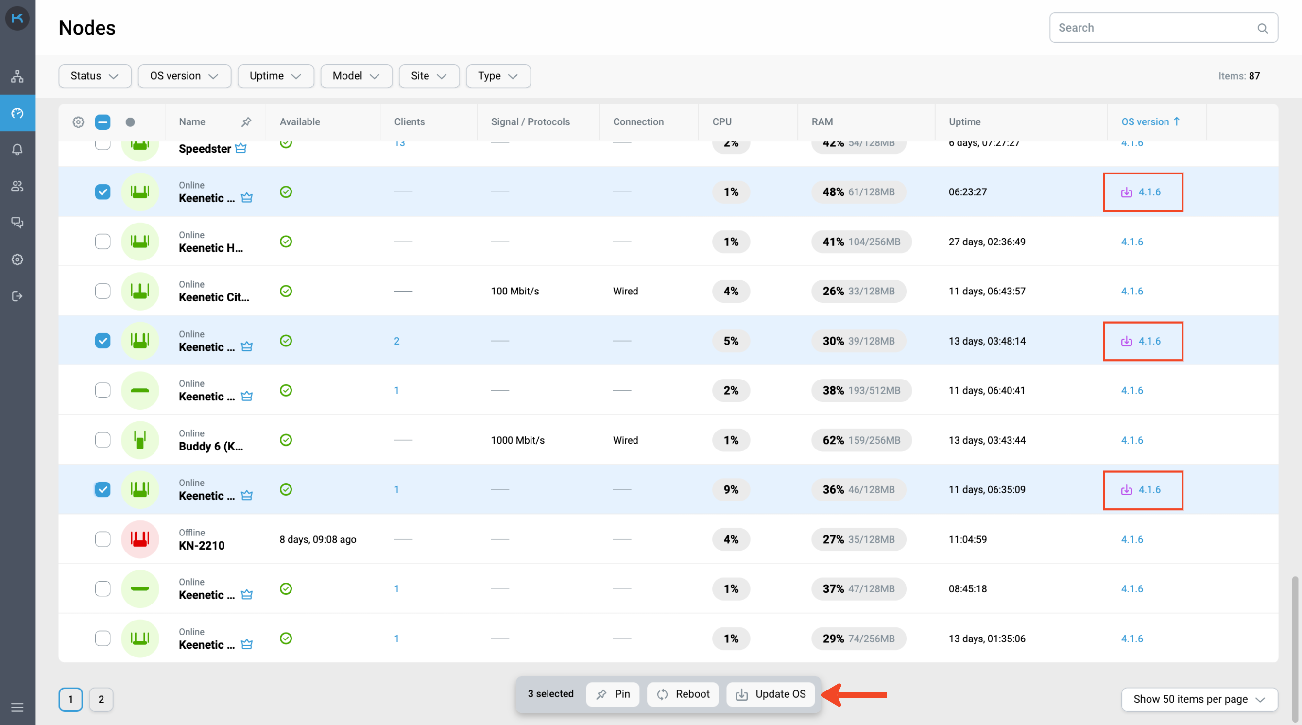

KeeneticOS update availability is displayed on the Nodes page using an icon and colour indication.
To update a node, click the icon and confirm the action.
TIP: Tip: For the best Mesh Wi-Fi System performance, it is recommended that all nodes run the same KeeneticOS version.
A group update feature is available for convenience. To update a group of Keenetic devices, select the nodes for which the update is available and click the "Update OS" button in the group operations menu.

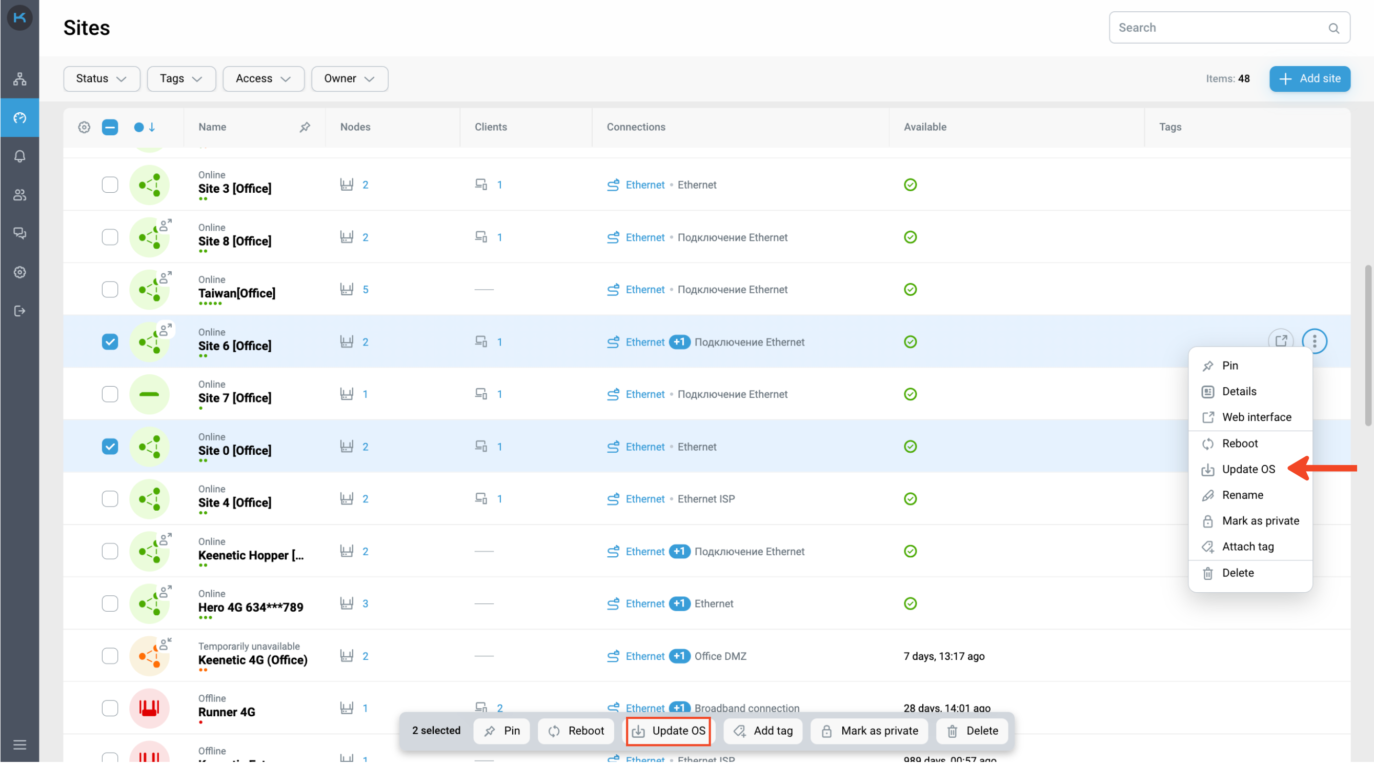

To update a site, click the "Update OS" button in the context menu and confirm the action.
To update a group of sites, select the sites and click the "Update OS" button in the group operations menu.

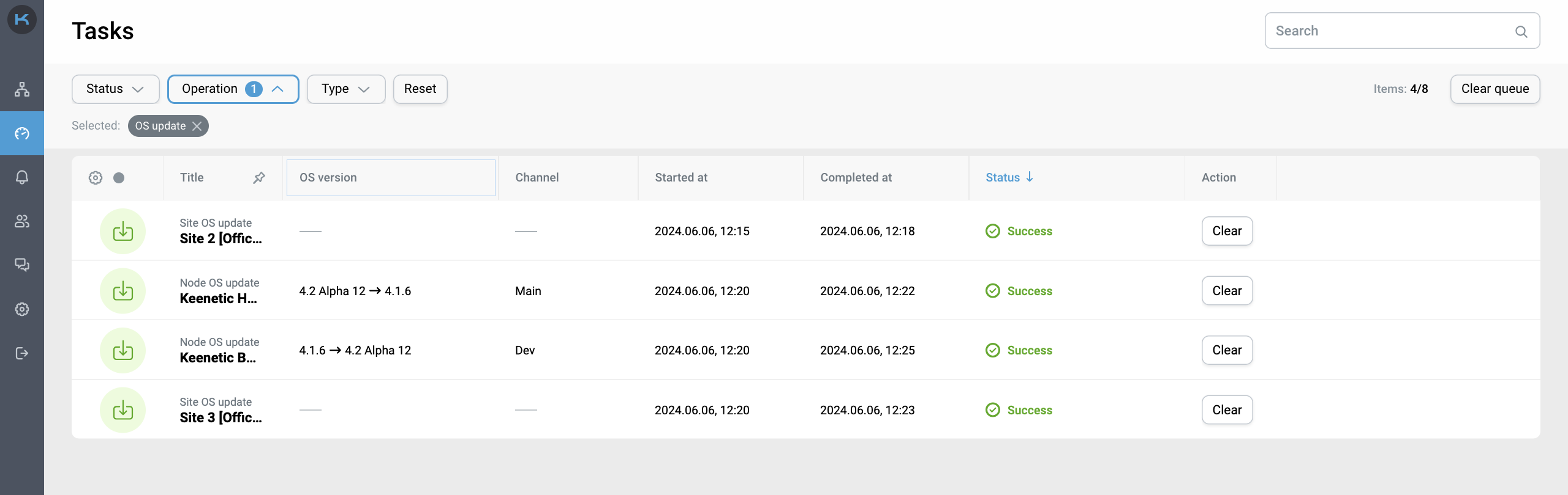

TIP: Note: Once the update has started, you are redirected to the Tasks page to track the status of the OS update.

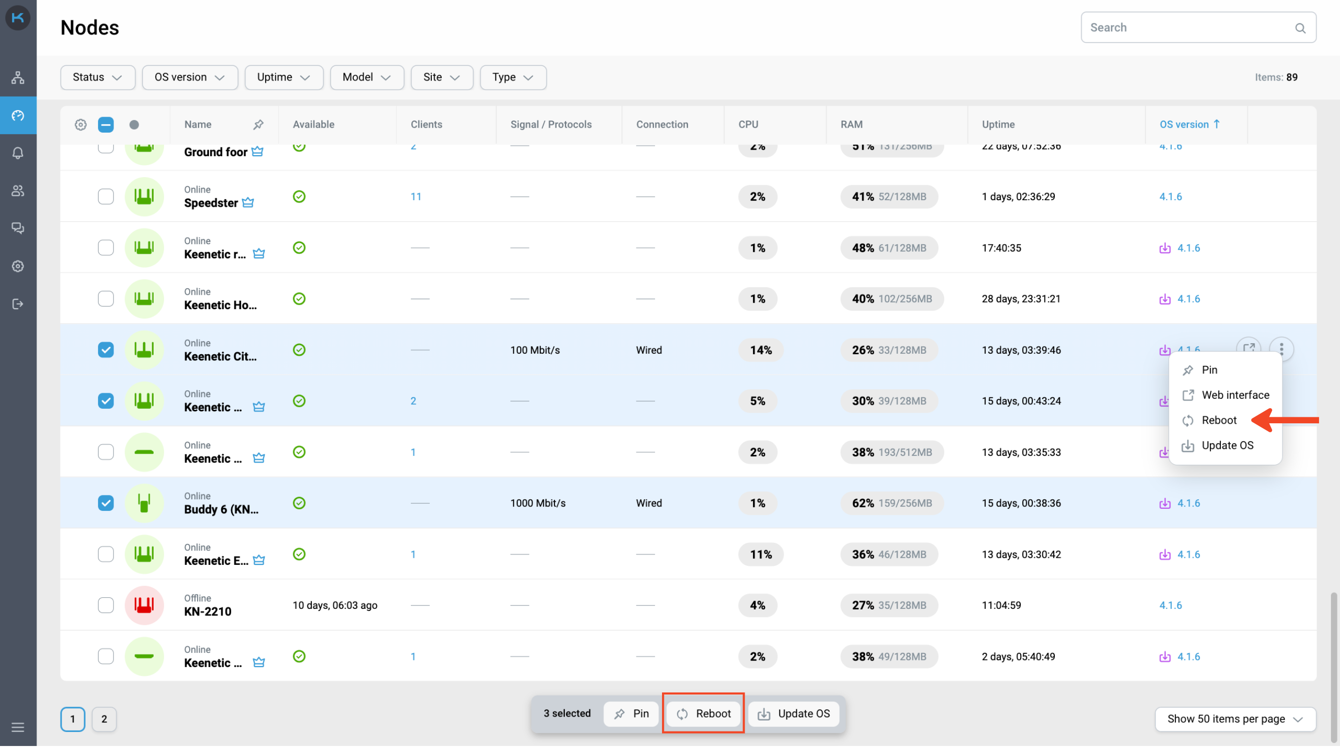

To reboot a node, click the "Reboot" button in the context menu and confirm the action. Reboot is available for both Wi-Fi System Routers and Extenders.
A group reboot feature is available for convenience. Select the nodes you want to reboot and click the “Reboot” button in the group operations menu.

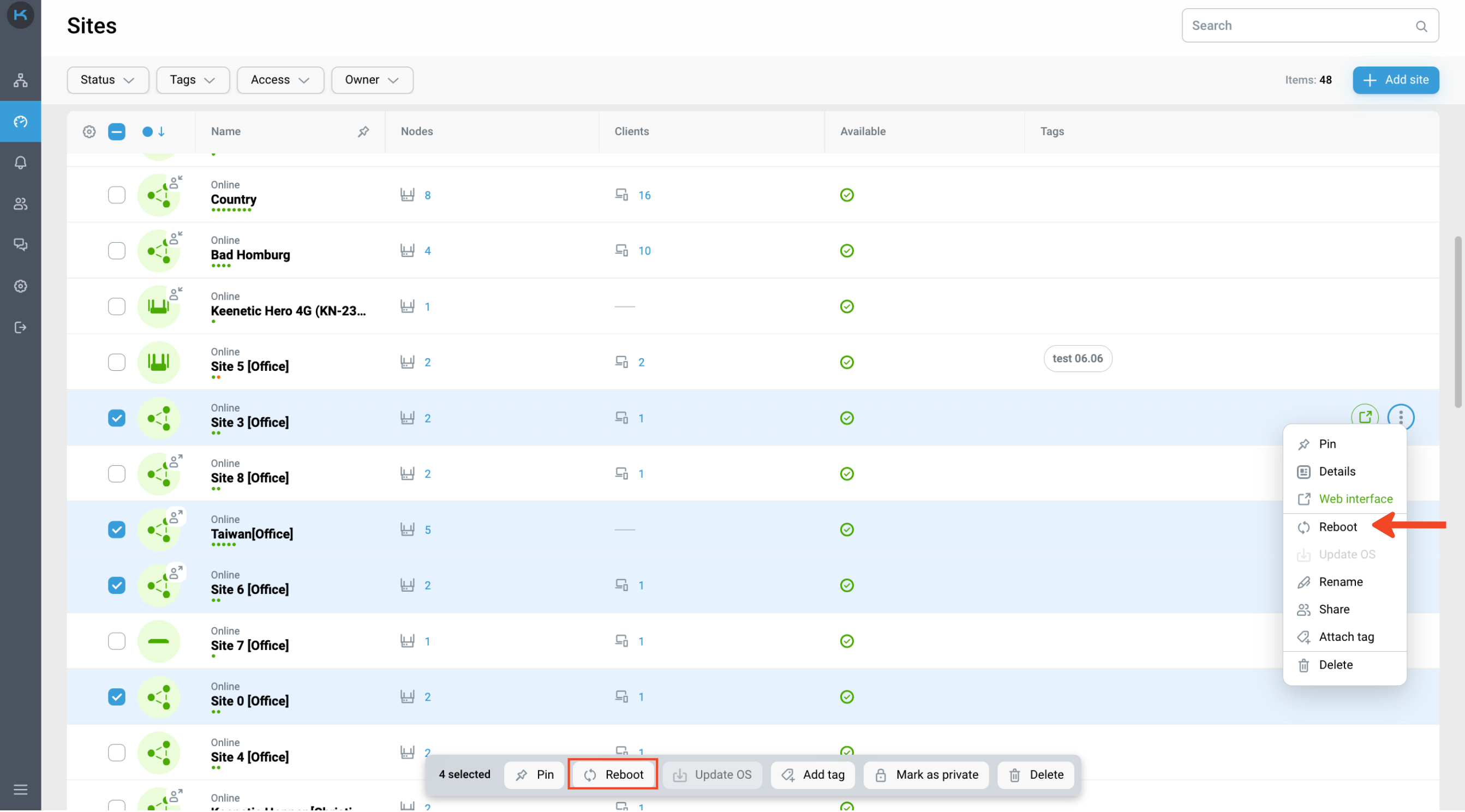

To reboot a site, click on the context menu, select “Reboot” and confirm the action.
A group reboot feature is available for convenience. Select the sites you want to reboot and click the “Reboot” button in the group operations menu.

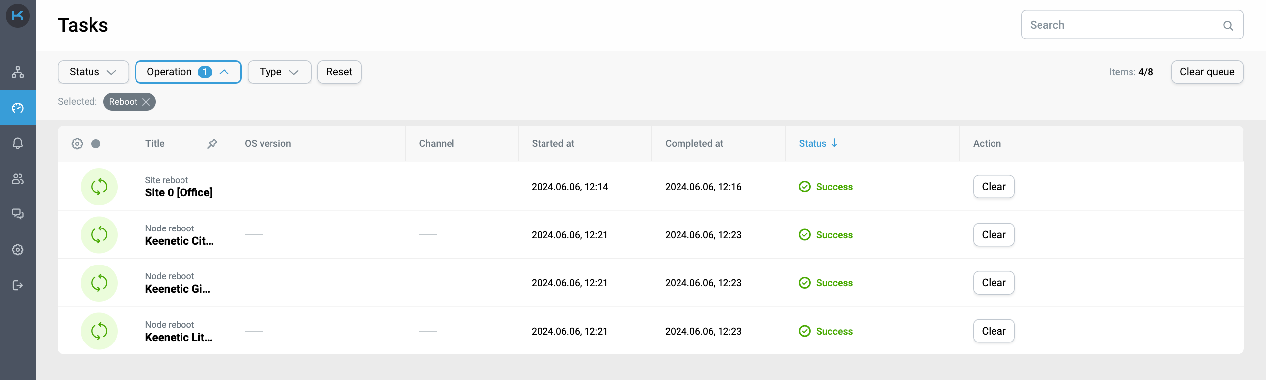

TIP: Note: Once the reboot has started, you are redirected to the Tasks page to track the reboot status.
