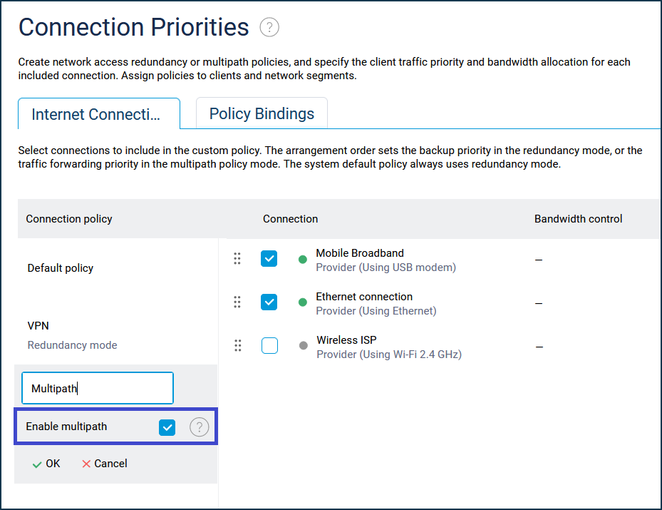

2. On the Connection Priorities page, add a new policy;
3. Activate the 'Enable multipath' option and tick the desired internet connections;
4. Move the device on which you want to get the aggregated speed of multiple connections to this policy;

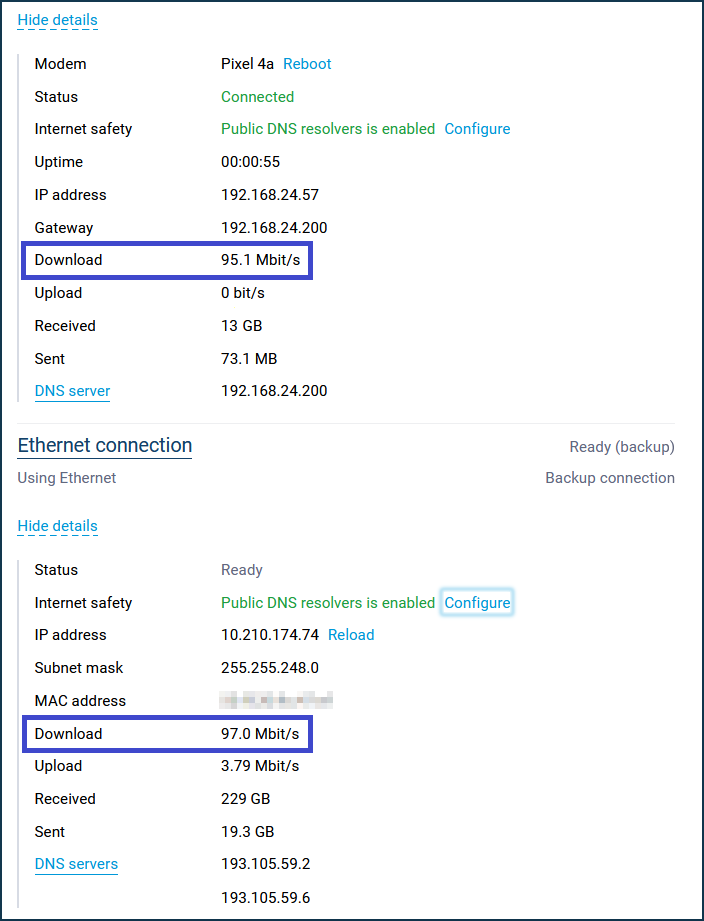

In the web interface, on the System Dashboard page, check the download speed on active Internet connections. In our example, the channel rate for each connection is up to 100 Mbps = 12.5 MB/s.
