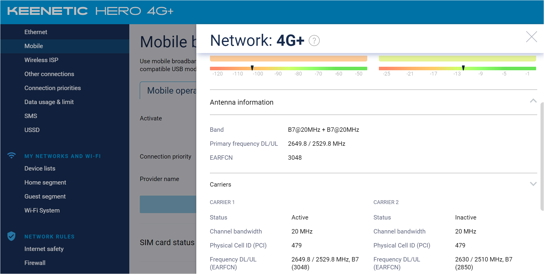

The web interface of Hero 4G+ (KN-2311) shows the connection frequencies in the aggregation under 'Mobile' > 'Carriers'.
