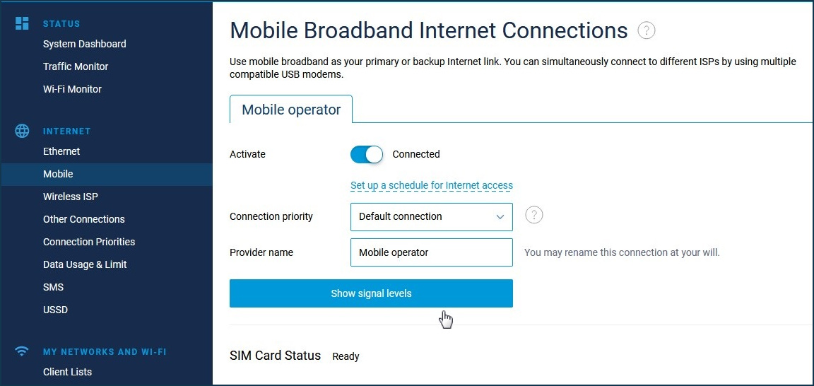

In Keenetic Runner 4G (KN-2211), Skipper 4G (KN-2910) and Hero 4G+ (KN-2311) routers, you can view antenna metrics in the web interface under Internet > Mobile.
Click on the 'Show signal levels' button.

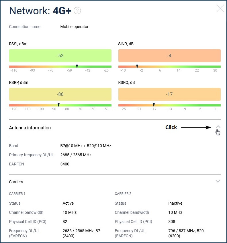

In the window that appears, expand the information under 'Antenna information' and click on the arrow on the right.

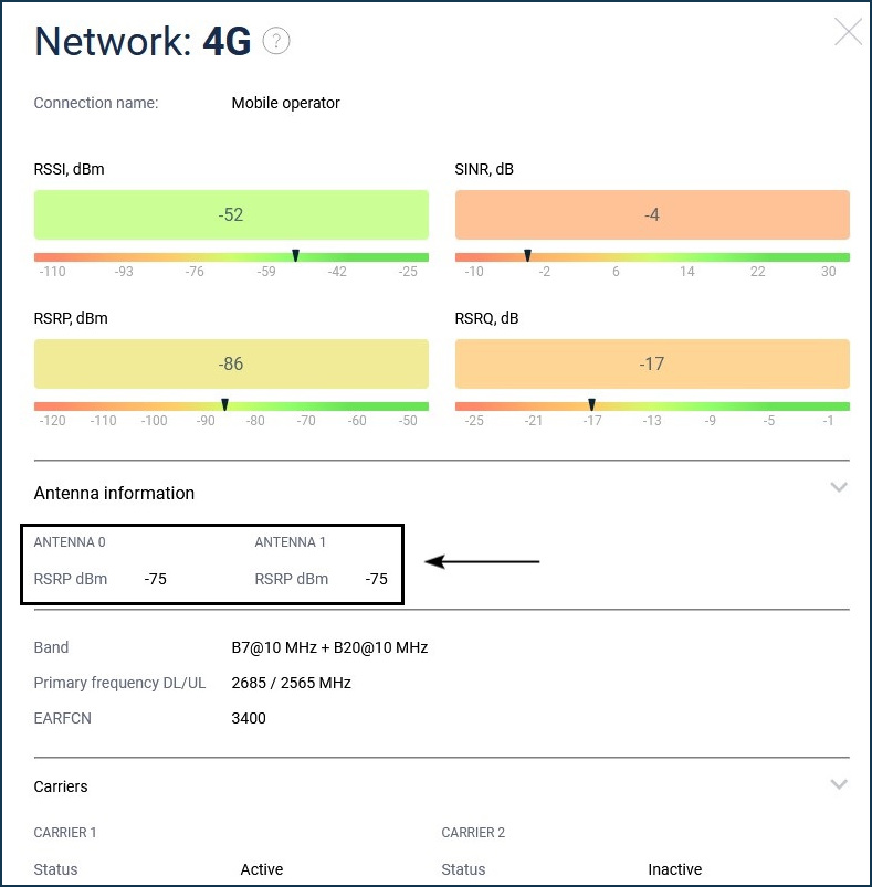

The 'Antenna information' section will display RSRP information, and some models will also display RSSI. For example:
The data in the 'Antenna 0' section refers to the SISO antenna connector. For more information, please refer to the guide Connecting outdoor directional antennas to Hero 4G(+), Skipper 4G and Runner 4G.
Information with a detailed description of RSRP and RSSI parameters can be found in the LTE signal quality parameters article.
