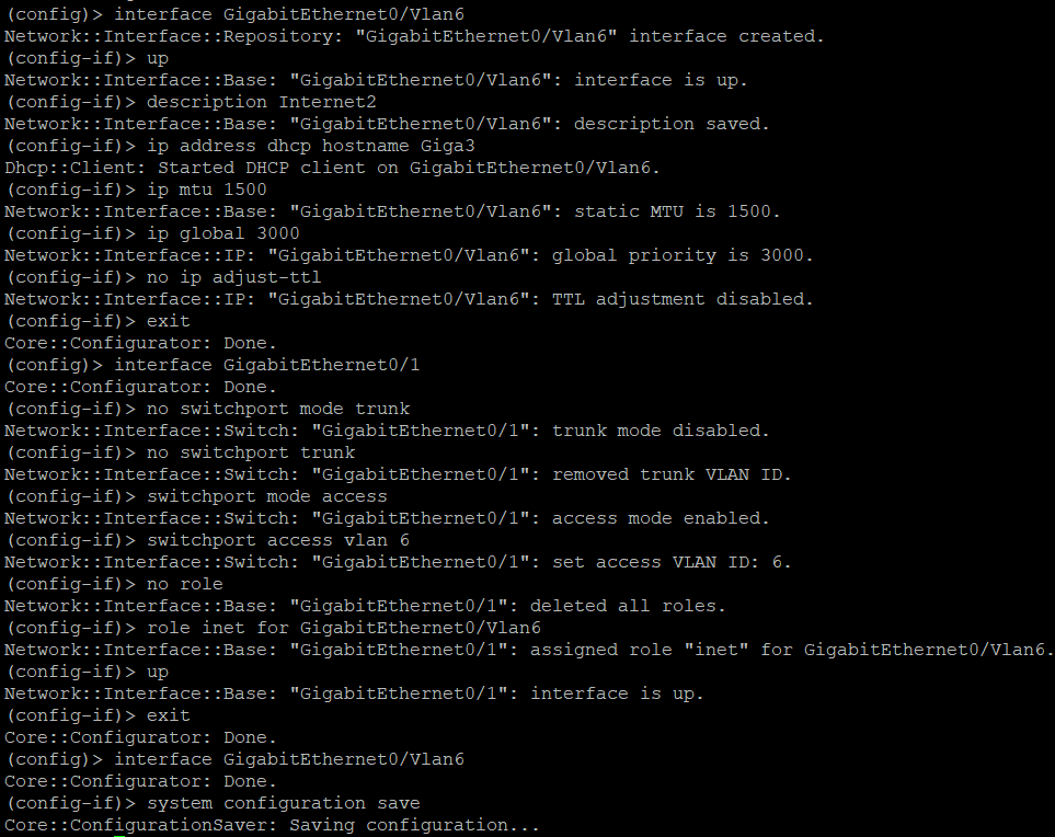

Если вам необходимо переназначить WAN-порт на любой свободный LAN-порт, то такая возможность есть. Для этого потребуется зайти в настройки Keenetic при помощи интерфейса командной строки (CLI) и выполнить указанную ниже настройку. Приведем пример переназначения WAN-порта (синий порт «0») на сетевой LAN-порт «2» домашней сети.
Login: admin
Password: ***************
(config)> interface GigabitEthernet0/Vlan6
Network::Interface::Repository: "GigabitEthernet0/Vlan6" interface created.
(config-if)> up
Network::Interface::Base: "GigabitEthernet0/Vlan6": interface is up.
(config-if)> description Internet2
Network::Interface::Base: "GigabitEthernet0/Vlan6": description saved.
(config-if)> ip address dhcp hostname Giga3
Dhcp::Client: Started DHCP client on GigabitEthernet0/Vlan6.
(config-if)> ip mtu 1500
Network::Interface::Base: "GigabitEthernet0/Vlan6": static MTU is 1500.
(config-if)> ip global 3000
Network::Interface::IP: "GigabitEthernet0/Vlan6": global priority is 3000.
(config-if)> no ip adjust-ttl
Network::Interface::IP: "GigabitEthernet0/Vlan6": TTL adjustment disabled.
(config-if)> exit
Core::Configurator: Done.
(config)> interface GigabitEthernet0/1
(config-if)> no switchport mode trunk
Network::Interface::Switch: "GigabitEthernet0/1": trunk mode disabled.
(config-if)> no switchport trunk
Network::Interface::Switch: "GigabitEthernet0/1": removed trunk VLAN ID.
(config-if)> switchport mode access
Network::Interface::Switch: "GigabitEthernet0/1": access mode enabled.
(config-if)> switchport access vlan 6
Network::Interface::Switch: "GigabitEthernet0/1": set access VLAN ID: 6.
(config-if)> no role
Network::Interface::Base: "GigabitEthernet0/1": deleted all roles.
(config-if)> role inet for GigabitEthernet0/Vlan6
Network::Interface::Base: "GigabitEthernet0/1": assigned role "inet" for GigabitEthernet0/Vlan6.
(config-if)> up
Network::Interface::Base: "GigabitEthernet0/1": interface is up.
(config-if)> exit
(config-if)> system configuration save

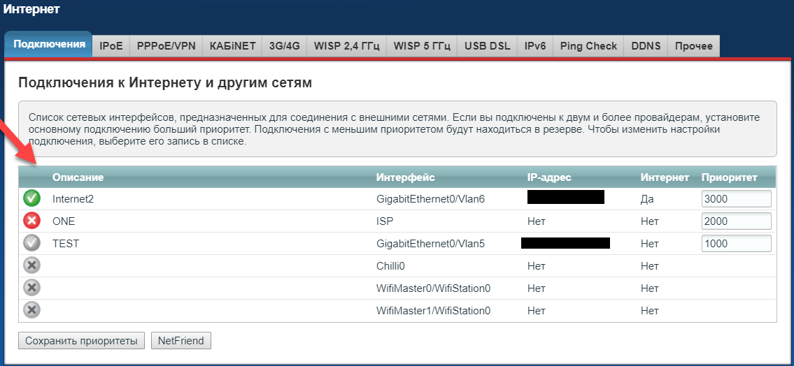

Далее проверяем в веб-интерфейсе созданный интерфейс в консоли:
Переназначение WAN-порта на любой свободный LAN-порт можно настроить и веб-интерфейсе. Для этого нужно подключиться к веб-конфигуратору интернет-центра, зайти в меню Интернет > IPoE и для дальнейшей настройки щелкните мышкой по кнопке Добавить интерфейс. Далее настраиваем интерфейс, как показано на скриншотах:
После создания интерфейса для него нужно выставить приоритет подключения. Для этого нужно подключиться к веб-конфигуратору интернет-центра, зайти в меню Интернет > Подключения и вписать цифровое значение в поле Приоритет, например 3000:
