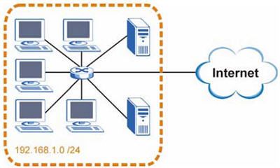

Subnets can be used to divide a single network into multiple networks. In the example below, the network administrator creates two subnets to isolate a group of servers from other devices for security purposes.
In this example, the company network has an address of 192.168.1.0. The first three octets of the address (192.168.1) represent the network number, and the remaining octet represents the host ID, allowing a maximum of 28 - 2 = 254 hosts on the network.
The company's network before it was divided into subnets is shown in the following diagram.
Figure 2: Example of subnet creation: before subnetting

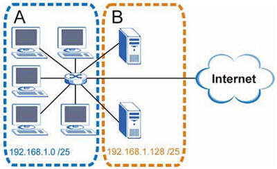

To split the 192.168.1.0 network into two separate subnets, you can 'borrow' one bit from the host ID. In this case, the subnet mask will become 25-bit (255.255.255.128 or /25).
The 'borrowed' bit of the host ID can be either zero or one, which gives us two subnets: 192.168.1.0 /25 and 192.168.1.128 /25.
The company network after it has been divided into subnets is shown in the following figure. It now includes two subnets, A and B.
a478a684-925c-4d15-9e01-8277a2acb7a1.jpg>
Figure 3: Example of subnetting: after division into subnets
In a 25-bit subnet, 7 bits are allocated to the host ID, so each subnet can have a maximum of 27 - 2 = 126 hosts (the host ID of all zeros is the subnet itself, and of all ones is the broadcast address for the subnet).
The address 192.168.1.0 with mask 255.255.255.128 is the address of subnet A, and 192.168.1.127 with mask 255.255.255.128 is its broadcast address. Thus, the smallest IP address that can be assigned to a valid host on subnet A is 192.168.1.1, and the largest is 192.168.1.126.
Similarly, the host ID range for subnet B is 192.168.1.129 to 192.168.1.254.
