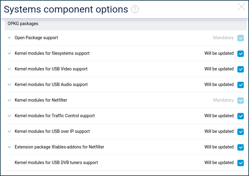

2. Install the OPKG components.
NOTE: Important! This method is available on models with the multifunctional USB port.

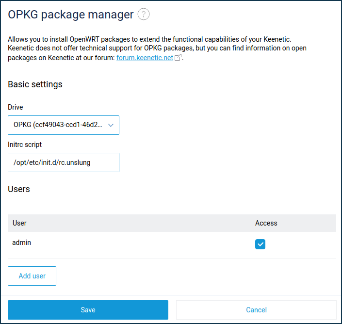

5. In the web interface, go to the 'OPKG' page and make the following settings:
  • Drive: OPKG (EXT4 partition label)
  • Initrc script: /opt/etc/init.d/rc.unslung
Click 'Save'.

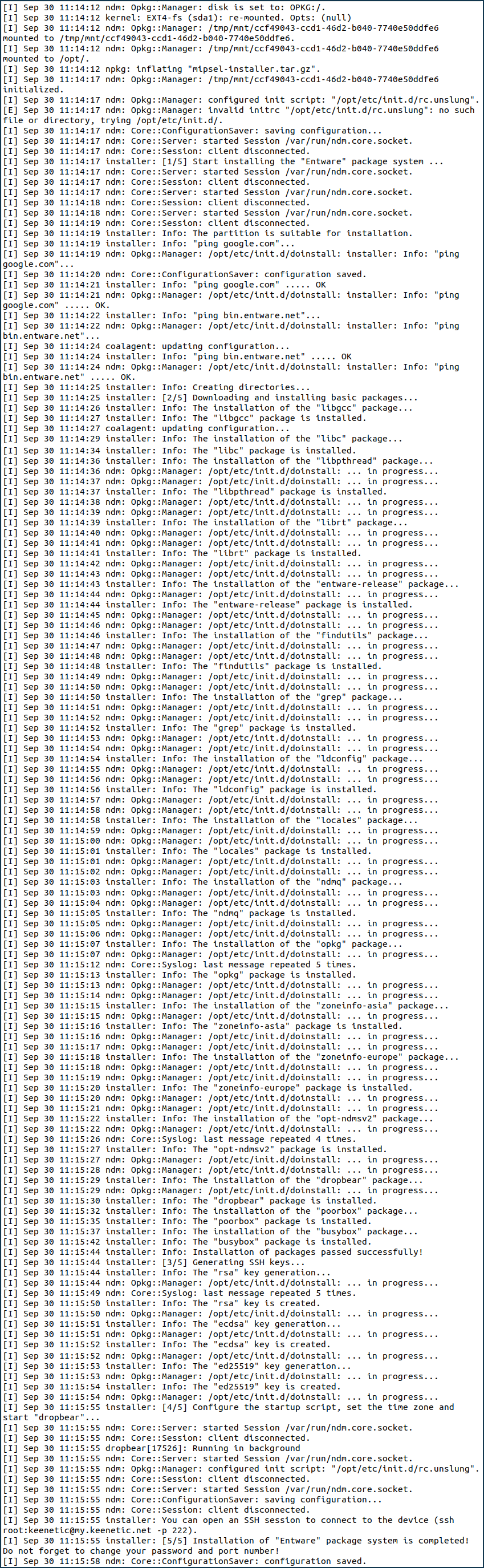

6. Go to the System log. It shall contain the following entries:

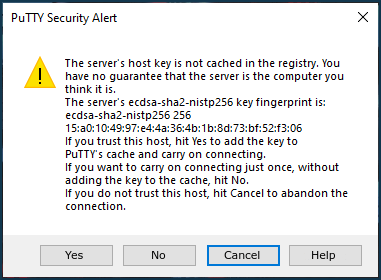

8. Run Putty. Select the SSH protocol, enter the IP address of the Home Vlan (Home Segment) 192.168.1.1, specify port 222, confirm the addition of the key to the Putty cache to continue the connection and go to the router settings using the Secure Shell protocol.

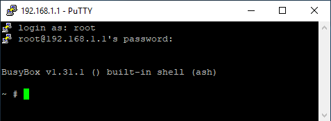

When loading, confirm your login by pressing YES. Then enter:
login as: root
root@192.168.1.1's password: keenetic

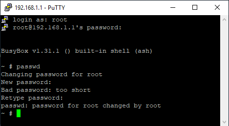

You can set your password. Enter the passwd command:

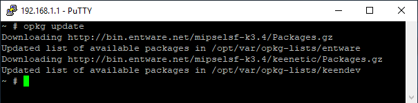

9. You have entered the v1.27.2 () built-in shell (ash). Now you need to update the opkg package. To do this enter the command opkg update:

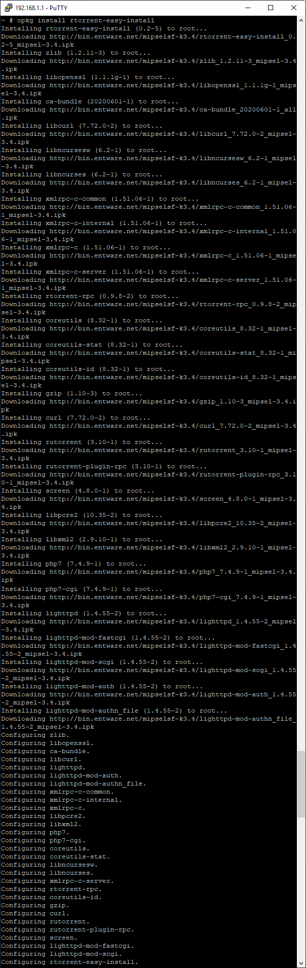

10. After updating the OPKG package, install the package rtorrent-easy-install.
To do this, run the command opkg install rtorrent-easy-install:

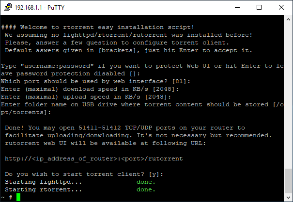

11. When the package is installed, you will be asked to configure the basic features at once.
You can set your login/password, port, upload/download speed, the path for downloading torrent files:

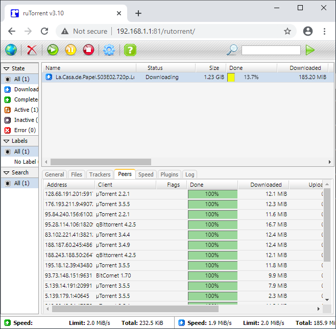

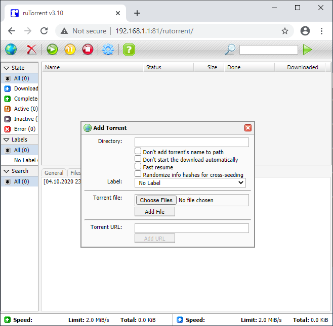

12. Go to the rTorrent web interface at http://192.168.1.1:81/rutorrent/, configure and check how it works:
