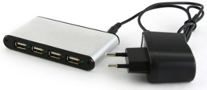

But if you have already purchased Keenetic with one USB port and you need to connect several devices, you can use a USB hub with its own power supply. This device is also called an 'active hub' or a hub with an external power supply. If you use a passive hub (without an external adapter), the power on the router's USB port may not be enough to properly work with two devices because the power on one USB port (2.0 or 3.0) of Keenetic is limited to 1A.
Keep in mind that the USB device may draw significantly more power if used intensively. It is recommended to use a hub whose power adapter supports at least 2 Amps.
