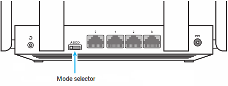

Some models of Keenetic routers are equipped with a physical mode switch on the case.
NOTE: Important! There is no possibility to change the operating mode in the web interface for models with a physical mode switch on the case. The mode can only be selected on these models using the mode switch.
On models with a 2-position operating mode switch, set it to position 'B'. The switch is located on the side panel of the router.
If the router is equipped with a 4-position operating mode switch (on the back panel), move the switch to the position according to the desired mode.
A — Router Mode (main)
B — Wi-Fi Adapter for wired devices
C — Wi-Fi Repeater/Extender Mode
D — Wi-Fi Access point/Extender Mode
