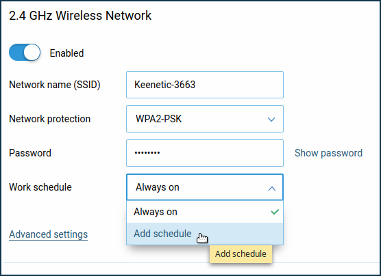

Imagine you have to turn off the Wi-Fi access point at night and turn it back on only in the morning. To do this, you need to create a schedule in the wireless settings on the 'Home segment' page. Click on 'Additional settings' in the 'Wireless Network' section. Choose 'Work schedule' - 'Add schedule' there.
In the schedule editor, set the schedule's name in the appropriate field (for example, wifi).

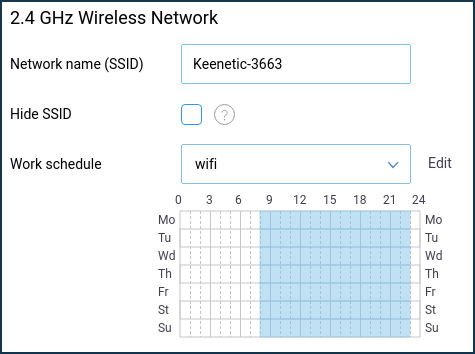

Next, select the areas corresponding to the working time, and leave the non-working hours unpainted (for example, every day from 8-00 to 23-00).
As a result, the Wi-Fi hotspot will work daily from 8 am to 11 pm. The rest of the time, it will not be available when searching for wireless networks from your mobile device (the Wi-Fi LED on your Keenetic will be off).
