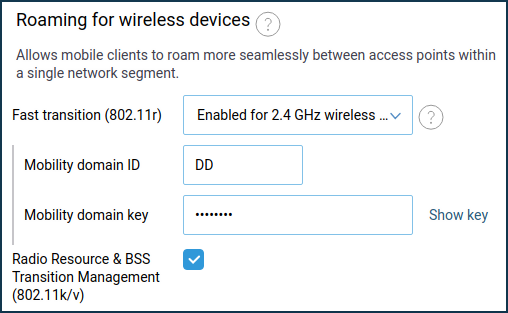

You can make Seamless roaming (802.11k/r/v) settings in Keenetic's web interface on the 'Home segment' page in the 'Wi-Fi seamless roaming' section. But first, you should add at least one Wi-Fi network to the segment. Fast Transition (802.11r) will work in networks protected by WPA2/WPA3. In a dual-band device (2.4 and 5 GHz), to unlock 802.11r, you must have only one Wi-Fi network or SSID; passwords and work schedule should be the same for both ranges.
Choose one of the following items in the 'Fast transition (802.11r)' list: 'Enabled for 2.4 GHz and 5 GHz', 'Enabled only for 2.4 GHz', 'Enabled only for 5 GHz' or 'Disabled'.
When you enable 802.11r, type the 'Mobility domain ID' and 'Mobility domain key'. The corresponding values of these parameters should be the same on all routers of the local network.
Turn on 'Radio Resource & BSS Transition Management (802.11k/v)'. It will allow the client to transmit information about neighbouring access points and their signal levels.
In KeeneticOS 3.3 and above, if 'Radio Resource & BSS Transition Management' is enabled, then 802.11k (RRM; Radio Resource Management) and 802.11v (WNM BTM; BSS Transition Management) support is enabled on the access point side, whether Band Steering is enabled or disabled. If Band Steering is enabled and the client supports 802.11v, this allows the router to manage clients who have declared WNM BTM (BSS Transition Management) support in response and send them to the adjacent band via BTM queries. If Band Steering is disabled and the 'Radio Resource & BSS Transition Management' option is enabled, you will see compatible clients declaring 802.11v support.
TIP: Tip: The optimal settings for seamless Wi-Fi roaming are as follows: Enable 802.11r for the 2.4 & 5 GHz bands, 802.11kv and set Band Steering to 'Prefer 5 GHz'. In exceptionally rare cases, a client device may not connect to the router's network. For details, see the article 'Why can't my device connect to Wi-Fi when my router has Fast Transition (802.11r) enabled?'
