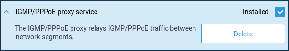

1. Multicast is used to provide IPTV services. Make sure that your Keenetic has the 'IGMP/PPPoE proxy service' component installed, which transmits IGMP/PPPoE messages between different interfaces. This can be done on the 'General system settings' page in the 'Updates and component options' section by clicking on 'Components options'.

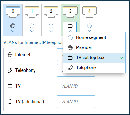

3. Some ISPs, when using the MAC address registration of the set-top box, require a special TV port on the router to which the set-top box should be connected. This port directly connects to the provider's network and allows the provider to see the set-top box's MAC address. To set one of the network ports belonging to the Home segment in the TV port mode, please refer to the following configuration methods:
Go to the 'Wired' page, in the 'Connection and VLAN' section set the 'TV set-top box' mode for the port to which the IPTV set-top box will be connected (in our example, the set-top box will be connected to port 3).
If your ISP has provided you with a VLAN for an IPTV service, enter it in the 'TV' field. If IPTV is provided without a VLAN, you usually do not need to select a port for the set-top box.
When you make these settings, the set-top box will connect directly to the ISP's network through a router. Connect the IPTV set-top box to the TV port and reboot it. The set-top box must obtain an IP address from your ISP's network and then you can receive digital television.
The above steps are usually enough to receive IPTV.

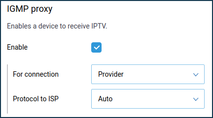

4. A Keenetic router also allows fine-tuning for non-standard connection scenarios, for example, which use a different interface for IPTV service.
As it was written above, it is necessary to have a component of the system 'IGMP/PPPoE proxy service' installed in the router. The IGMP proxy service retransmits a multicast stream from the ISP to the home network devices. Multicast is used to provide IPTV service.
Go to the 'Home segment' page in the 'IGMP proxy' section. The default settings on this page are suitable for most service providers.
By default, the 'For connection' field specifies the interface that looks into the provider's network (in our example it is 'Provider') and where IPTV will come from.
