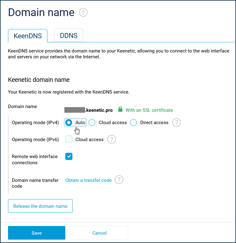

In the router's web interface, on the 'Domain name' page, on the KeenDNS tab, set the 'Auto' option to 'Operating mode (IPv4)'.
To check, you can run the command ping sample_name.keenetic.pro in your computer's operating system (use your registered name in KeenDNS instead of sample_name.keenetic.pro). When working via an ISP connection with a public IP, this command should determine the ISP-issued IP address (you can see it under 'System dashboard' > Connection details). And when switching to a backup connection (in our example, it is a 3G/4G modem connection), pinging the KeenDNS name will show the IP address of the Keenetic cloud server, as the 'Cloud access' mode will be activated.
