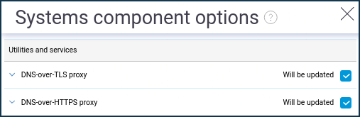

For the DoT/DoH protocol to work, system components: 'DNS-over-TLS proxy' and 'DNS-over-HTTPS proxy' are needed to be installed. Please open 'System component options' menu by clicking on the 'Component options' button in the 'Management - System settings' section and mark the required components for installation.

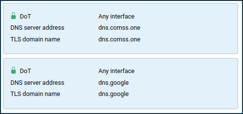

DNS-over-TLS
Click the 'Add server' link at the bottom of the page.
The fields for filling in the server parameters will appear. Specify the DNS server address (in our example 1.1.1.1 and 1.0.0.1), the TLS domain name (in our example cloudflare-dns.com), and, if necessary, the connection interface (the default setting is 'Any interface').
For example:
In the 'DNS server address' field, it is allowed to specify the FQDN domain name, e.g.:
Important! For stable DNS resolving, it is necessary to specify several DoT/DoH servers at once, preferably from different DNS services. For example:
DNS server address TLS domain name
8.8.8.8 dns.google
8.8.4.4 dns.google
1.1.1.1 cloudflare-dns.com
1.0.0.1 cloudflare-dns.com
9.9.9.9 dns.quad9.net
94.140.14.14 dns.adguard-dns.com
94.140.15.15 dns.adguard-dns.com

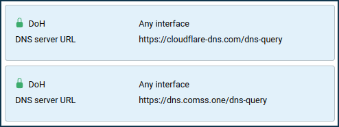

DNS-over-HTTPS
Click the 'Add server' link at the bottom of the 'DNS Configuration' tab.
Fields to fill in specific parameters will appear. In the 'DNS server type' field, specify 'DNS-over-HTTPS', in the 'DNS server address' field, specify the name of the DNS server and, if necessary, specify the connection interface (the default setting is 'Any interface'). These queries use the DNS message format. In our example, the https://cloudflare-dns.com/dns-query and https://dns.comss.one/dns-query servers are added.
For example:

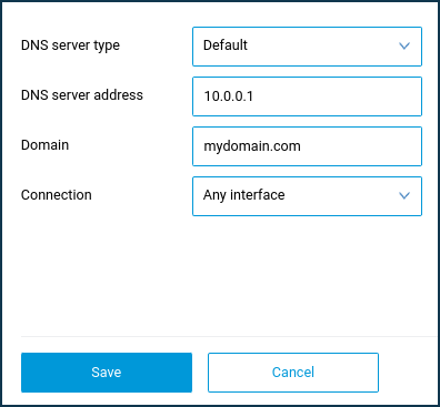

3. To prevent a DNS query from being hijacked, specify the domain when adding a DNS server. For example:
