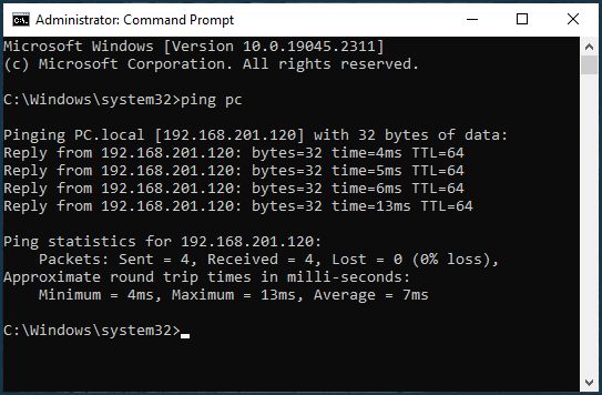

From the laptop, run the ping pc command to ping the computer.
By typing \\pc in the address bar of Windows Explorer, you will see a list of shared network resources.
Now from the computer, run ping notebook.
As we can see, hostname and IP address mapping is automatically triggered.
