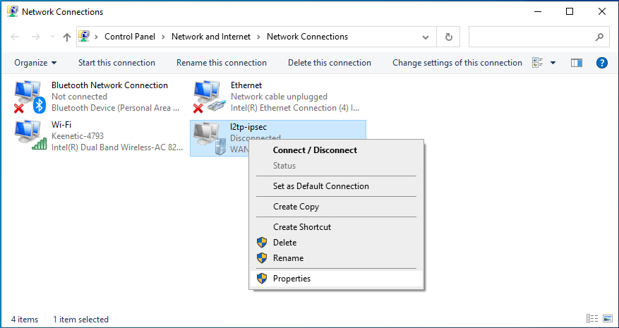

To manage these settings in Windows, you need to enter the properties of the VPN connection. To do this, open Control Panel and go to 'Network Connections'. Then right-click on the previously created VPN connection shortcut, and in the context menu, click 'Properties'.
