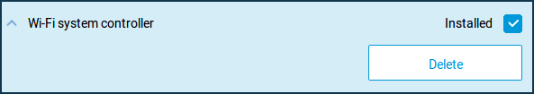

TIP: Note:
If there is no 'Wi-Fi System' menu section in the settings of the Main Router, in this case, a special component 'Wi-Fi system controller' must be installed. You can do this on the 'General system settings' page in the 'Updates and component options' section by clicking on Component options.
