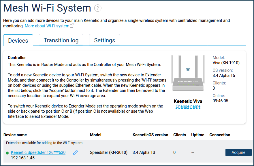

5. Open a web browser, go to my.keenetic.net, log in to the Main Router's web interface. Select the 'Wi-Fi system' section and click 'Acquire' to add the Extender to your Wi-Fi System.

5. Open a web browser, go to my.keenetic.net, log in to the Main Router's web interface. Select the Wi-Fi System section and click 'Acquire' to add the Extender to your Wi-Fi System.
Wait until the process is complete.

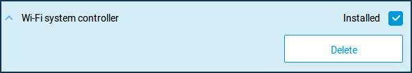

TIP: Note:
If there is no 'Wi-Fi System' menu section in the settings of the Main Router, in this case, a special component 'Wi-Fi system controller' must be installed. You can do this on the 'General system settings' page in the 'Updates and component options' section by clicking on Component options.
