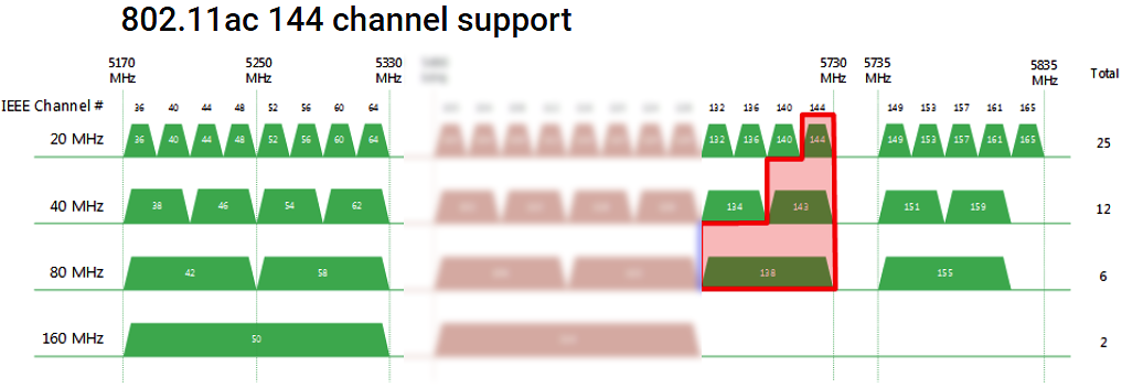

There is also a nuance in using channel 144 in the 5 GHz band: not all devices support it, so it is excluded from the router's auto channel selection.
If the device cannot see the narrow channel 144 (20 MHz), it will also not see the wider channel blocks (40 MHz, 80 MHz) that include this 144 channel.
Channel 144 with 20 MHz width was previously added to the official IEEE 802.11ac (Wi-Fi 5) standard specification. Support for a wide range of 132-144 channels (40 MHz, 80 MHz) was later added to the standard. But most outdated 802.11a and 802.11n clients do not support channel 144. These clients will use 20 MHz width for 132, 136, 140 channels (for 802.11n 5 GHz), and 40 MHz width for 132+136 channels' block.
Currently, many devices comply with the old FCC specifications and cannot work with the 144 channel. Channels 144 (20 MHz), 143 (40 MHz), and 138 (80 MHz) frequently cannot be used.
