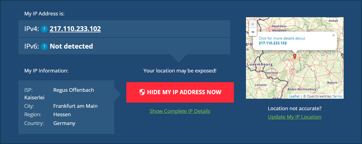

At the end of the trace, we can see that the IP packet routing goes through the servers of the local ISP Regus Offenbach Kaiserlei (from Hop 3) to the whatismyipaddress.com node (104.16.155.36).
The resource whatismyipaddress.com will show the IP address allocated by the ISP:

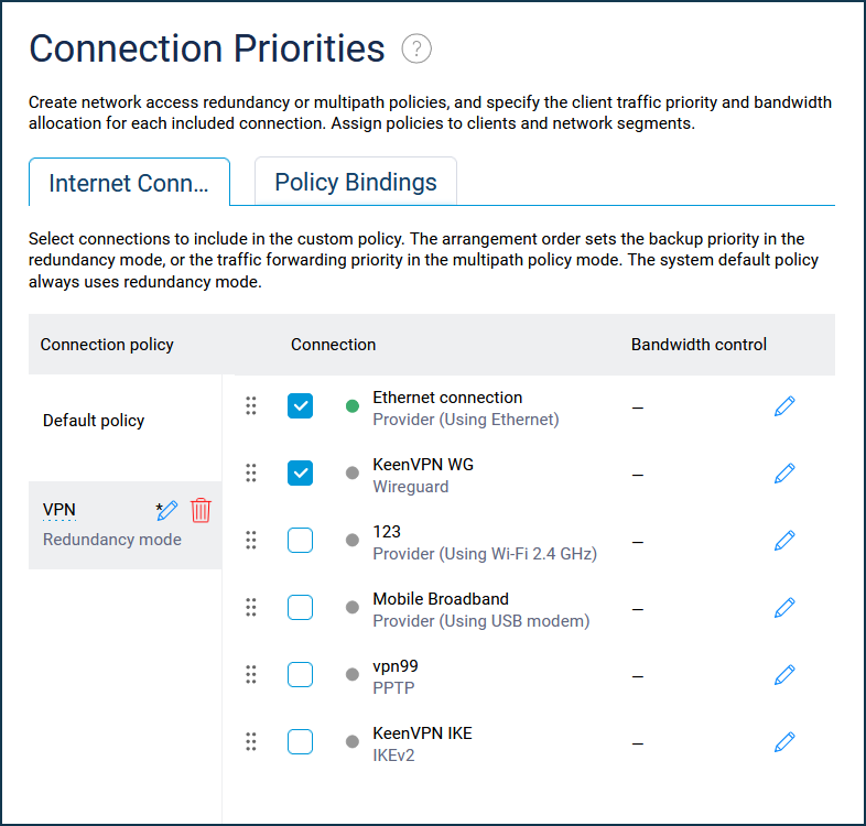

NOTE: Important! If Connection Priorities are configured, the interfaces for connections through the ISP and the VPN provider must be in the same profile.

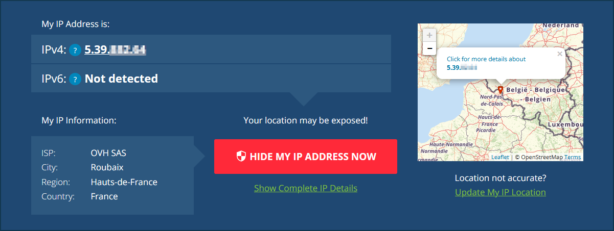

The whatismyipaddress.com resource will show the IP address allocated by the VPN provider:
