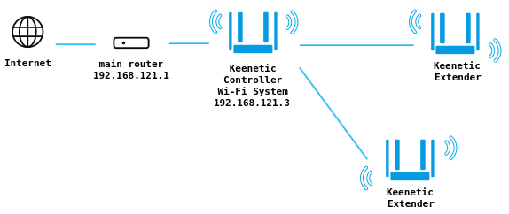

In a typical usage scenario, the Wi-Fi System Controller is the Main Router, the main gateway to the network. The Wi-Fi System Controller can only work on a Keenetic in the Router Mode. But technically, it is possible to use a third-party router as the main gateway, and on the Keenetic Controller in the 'Home segment' settings to turn off the DHCP server and connect its LAN port to the main router, assigning a free IP address from the subnet of the main router. Do not use the WAN port '0' or switch it to LAN mode by removing the 'ISP' connection in 'Internet' -> 'Ethernet'.

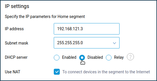

2. On the Controller, in the web interface, on the Home segment page, turn off the DHCP server and assign a free IP address from the subnet of the main router (in our example, 192.168.121.3).
There's no need to turn off NAT; it just will not be used because the router will not be using the external WAN interface.

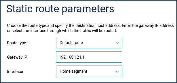

On the 'Routing' page, under 'User-defined routes', click 'Create route' and create a default route for the 'Home segment' interface by specifying the local IP address of the main router on the network as the gateway address (in our example it is 192.168.121.1).

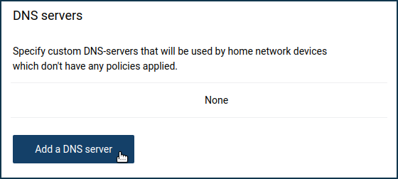

On the 'Internet safety' page, click 'Add a DNS server' in the DNS servers section.

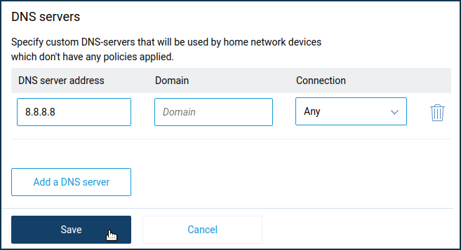

In the 'DNS server address' field, type in the IP address of the DNS server (in our example, it's a public DNS server from Google: 8.8.8.8) and then click 'Save'.

5. Connect the Controller and extenders to the main router's network and make sure that all extenders receive IP addresses from the main router's network.
6. On the Controller, acquire extenders into the Wi-Fi System.
