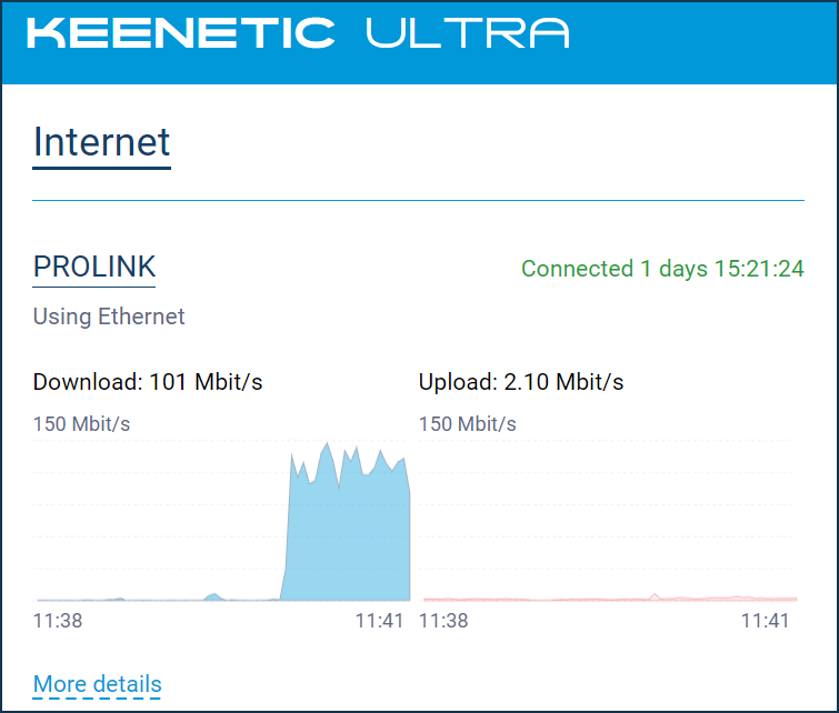

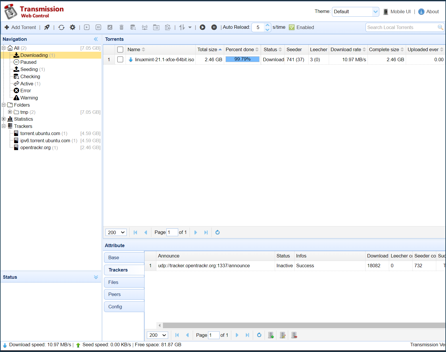

For the test, we connect an SSD drive to a Keenetic Titan (KN-1810) and, on default settings, get the following speeds:
In our example WAN port speed is 100 Mbit/s, the tariff is up to 100 Mbit/s too, and the torrent client has a download speed to disk up to 100 Mbit/s = up to 11 Mbytes/s:

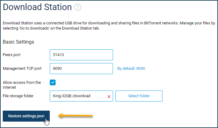

2. In the web interface, go to the 'Applications' menu under 'Download Station' and delete the application configuration file by clicking 'Restore settings.json':

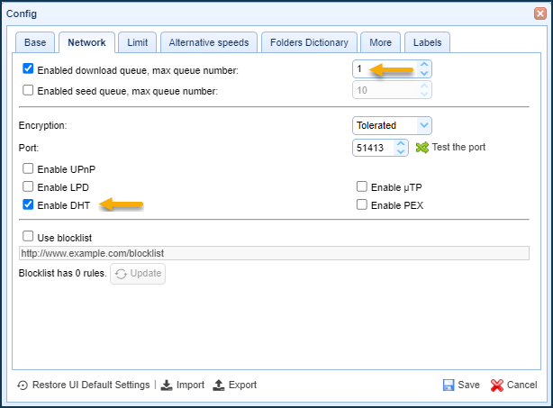

3. Go to the torrent client interface (GUI), check 'Enable DHT' and set the 'Enable download queue, max queue number' field to '1':

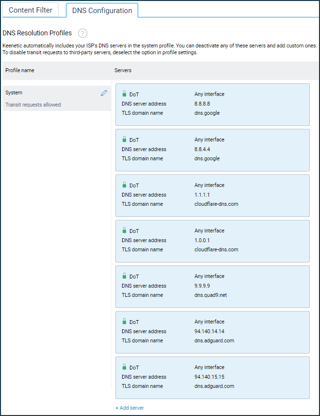

4. Add a setting for sending DNS queries of domain names over DNS over TLS (DoT):
