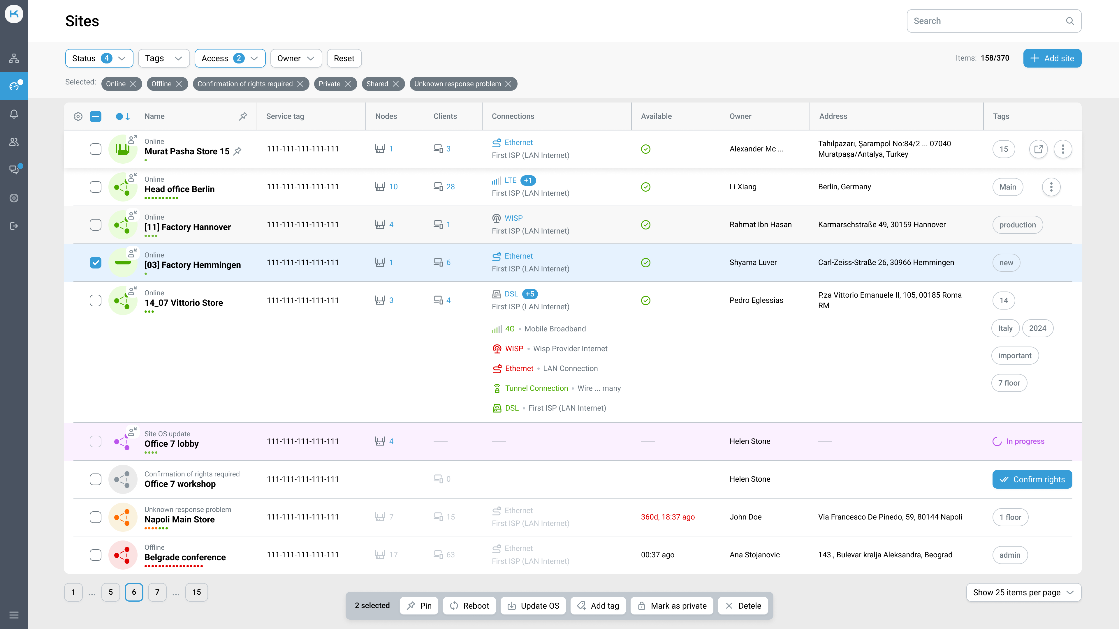

Site and node statuses
Keenetic RMM provides several statuses for sites and nodes to track their health and react quickly to changes.
The statuses are displayed on the Sites and Nodes pages and, with an extended description, on the Site detail page.
Status Description Colour
Online The site/node is available. Note, that data is updated periodically. Green
Offline The site/node is not available. Red
Loading The site data is loading. Please wait, this may take some time. Note that this is the router's initial status until the connection is established. Grey
Confirmation of rights required The confirmation of access rights is required. Click the “Confirm rights“ button and enter the node login and password. Until the rights are confirmed, the node data doesn't get updated in the Keenetic RMM. Grey
Extender mode not supported Extender added as site isn’t supported in the Keenetic RMM. Please, use the node in the router mode when adding a site. Grey
Pending activation Waiting for the isp-locked router activation. Blue
Unknown network error Please contact our Support. Yellow
Unknown response error Please contact our Support. Yellow
Access denied Reset the node to factory settings, or delete the node and add it again. Yellow
KeenDNS not found KeenDNS may have been changed recently. Check KeenDNS against the address displayed in the node's web interface. Yellow
SSL connection failed Failed to establish a secure connection to the node. Please contact our Support. Yellow
Timeout error Failed to connect to the node within a set time interval. Check the quality of the Internet connection and try again. Yellow
KeeneticOS version not supported Please, update KeeneticOS to the latest version. Yellow
Cloud component not installed Cloud-based remote control and KeenDNS component is not installed on the node. Install the component and update the KeeneticOS to the latest version. Yellow
Temporarily unavailable Please wait for a while or reboot the node. If the status doesn't change after that, contact our Support. Yellow
Connection failure Unstable connection between the extender and the router. Check the quality of the connection and try again. Yellow
Reboot The site/node reboot is started from the Keenetic RMM interface. Please wait for a while. Purple
OS update The KeeneticOS update is started from the Keenetic RMM interface. Please wait for a while. Purple
