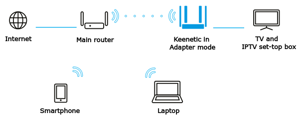

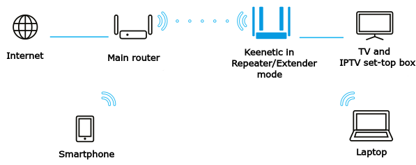

1. If you did not configure IPTV (only IGMP Proxy is enabled on the 'Home segment' page and in the 'IPTV Service connection' field, the Internet connection is specified), just use an additional Keenetic device in Repeater/Extender or Adapter mode to connect clients.
Choose the best spot to place the additional device. You need to find a place where it receives a strong Wi-Fi signal from the Main Router. Ideally, the Repeater/Adapter and the Main Router are in the line of sight.

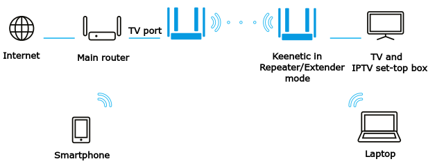

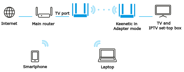

2. If you had to select a particular TV port on the Main Router for your IPTV service (this port connects directly, in 'transparent bridge' mode, to the ISP's network via the Internet WAN port and allows the ISP to see the set-top box's MAC address). You will need two Keenetic devices, one of which will be configured in an additional Access point/Extender mode and connected with a network cable to the TV port of the Main Router. The second Keenetic will be configured in Repeater/Extender or Adapter mode, and the set-top box will be connected to it.
