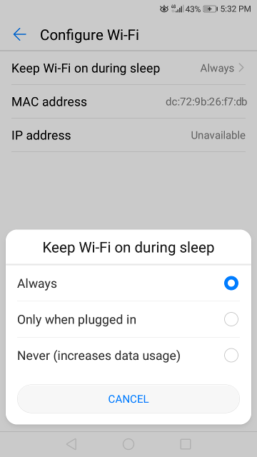

3. It also makes sense to disable the power-saving options of the Wi-Fi module on mobile devices. Set 'Keep Wi-Fi on during sleep' to 'Always' in Android Wi-Fi Advanced Settings.
