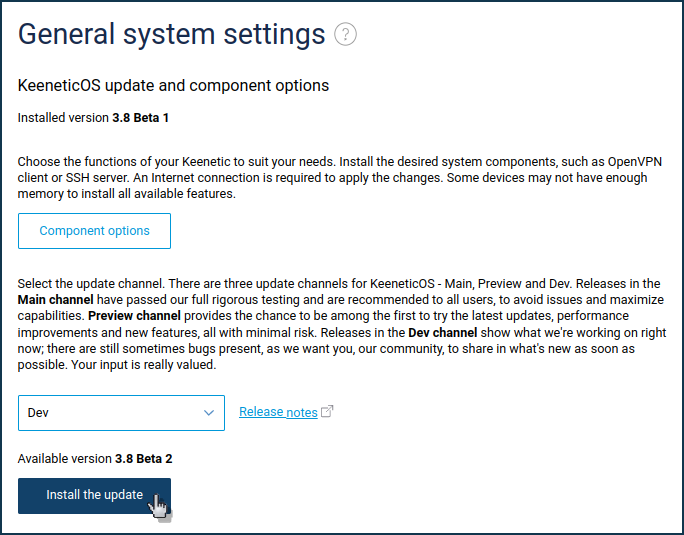

Go to the 'General system settings' page and select the KeeneticOS update channel 'Dev'.

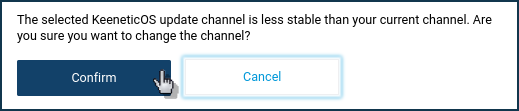

The message 'The selected KeeneticOS upgrade channel is less stable than your current channel. Are you sure you want to change the channel?' will appear. Click 'Confirm' to continue.
Then click 'Install the update' to update the router's built-in operating system.

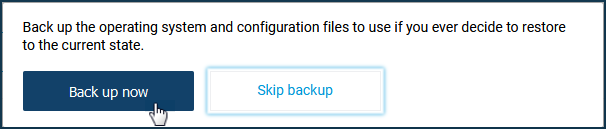

An information window will appear with the message 'Back up the operating system and configuration files to use if you ever decide to restore to the current state'. Click on 'Back up now' to save the startup-config.txt file and the KeeneticOS firmware.bin (router OS) image.
The message 'Allow KeeneticOS and system configuration files to finish downloading. The device will reboot after the updates'. Click 'Confirm'.

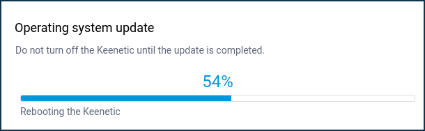

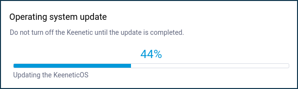

The KeeneticOS firmware update process will start.
NOTE: Important! Do not switch off the router until the update process is complete.
After the firmware update, the router will automatically reboot and be ready to work again.
