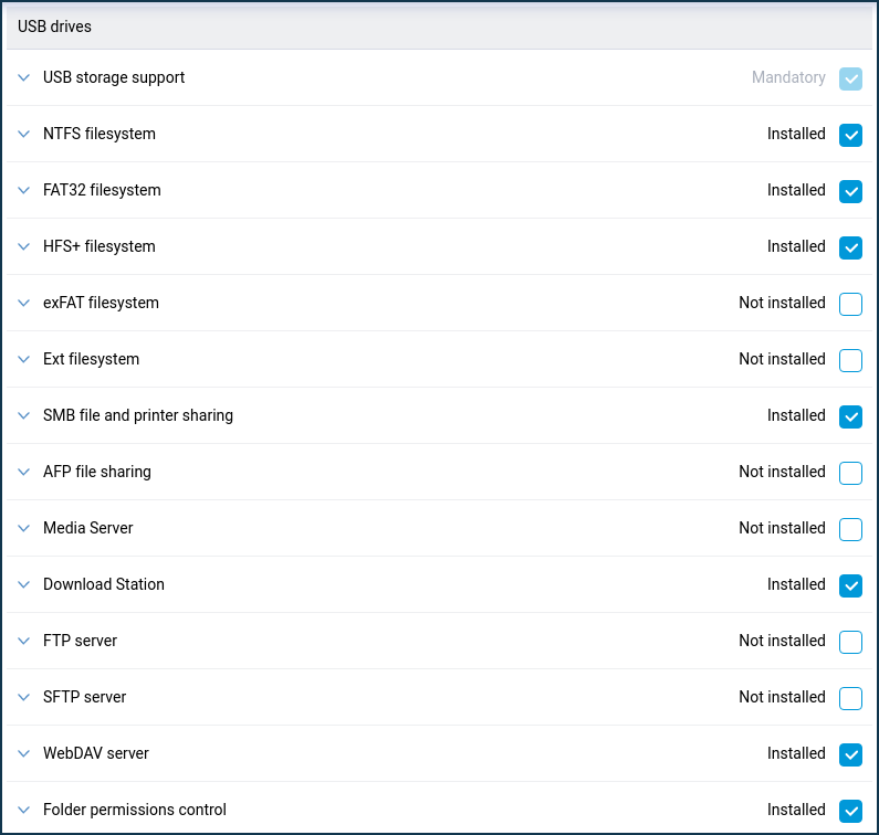

1. Open the router's web interface in your browser and make sure that the router's system components responsible for working with the USB interface and USB storage devices, as well as support for storage file systems, are installed in the router's settings. You can do this on the 'General system settings' page under 'Component options' by clicking 'Component options'.
Make sure that the most important 'SMB file and printer sharing' component is installed, as well as the components for your drive's file system. For example, if you connect a USB drive with the NTFS file system, the 'NTFS filesystem' component must be installed; if you connect a USB drive with the FAT32 file system, the 'FAT32 filesystem' component must be installed.
Starting with KeeneticOS 3.5, support for Ext file systems has been moved to a separate component. When you connect a USB storage device with the Ext2/Ext3/Ext4 file system, the 'Ext filesystem' component must be installed.

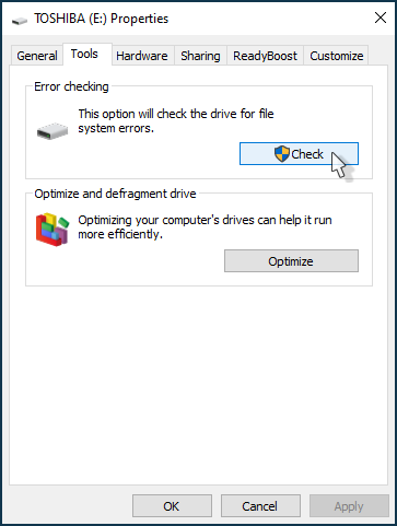

4. If in the router's web interface, under 'USB devices' in the connected drive entry, you see a 'Dirty filesystem' status, you need to check the drive or USB stick for errors on your computer.
4.1. Connect the USB drive to a Windows computer and check it for errors using standard operating system tools or the CHKDSK utility.
The easiest way to check the drive in Windows is to use File Explorer. Connect the drive to your computer. Start Windows Explorer, right-click on the drive you want to check for file system errors, select Properties, click the Tools tab, and click Check.
4.2. To check the drive for errors using the CHKDSK utility, proceed as follows:
Use the command chkdsk G: /f /r /x, at the Windows command line, where G is the drive letter assigned to the connected drive. The flags /f /r /x specify:
