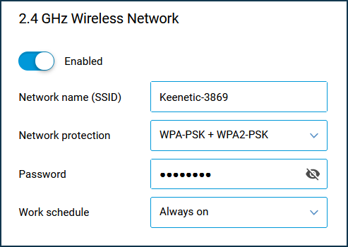

2. Some mobile devices may not work correctly with Wi-Fi access points that have mixed encryption modes 'WPA-PSK + WPA2-PSK' and 'WPA2-PSK + WPA3-PSK'.
WPA+WPA2 is rarely used these days, as WPA-only devices are hard to find, and WPA2+WPA3 should only be activated if you are sure that all devices will operate correctly in this mode.

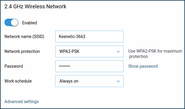

Check the network security mode set on your router in the 'Home segment' menu. If you have a mixed mode set, deactivate it under 'Wireless Network' and set Network security to 'WPA2-PSK'.
If your home network for most mobile devices needs to keep using a specific network security protocol (e.g. WPA3-PSK), create a separate additional access point (with WPA2-PSK mode). Only connect to it clients who do not have WPA3 support or have trouble connecting to the primary network. How to create an additional Wi-Fi access point is shown in the Note at the end of these instructions.

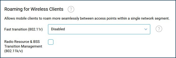

3. Keenetic routers have 'Roaming for wireless devices' enabled by default. There may potentially be compatibility issues between some clients and the access point. Sometimes mobile devices cannot connect via Wi-Fi to a router with 802.11r (FT) roaming enabled. This depends on the Wi-Fi driver implementation on the mobile device. For more information, see 'Why can't my device connect to Wi-Fi when my router has Fast Transition (802.11r) enabled?'.
Disable seamless Wi-Fi roaming in the web interface on the 'Home segment' page. Set 'Fast transition (802.11r)' and 'Radio Resource & BSS Transition Management (802.11k/v)' to 'Disabled' and then try to reconnect the device to the Wi-Fi network.
If you are using a Wi-Fi System in your home network and seamless roaming operation is required for most mobile devices, create a separate additional access point with 'Fast transition (802.11r)' and 'Radio Resource & BSS Transition Management (802.11k/v)' turned off in its settings. Only connect customers who are experiencing problems connecting to the main network. How to create an additional Wi-Fi access point is shown in the Note at the end of these instructions.
